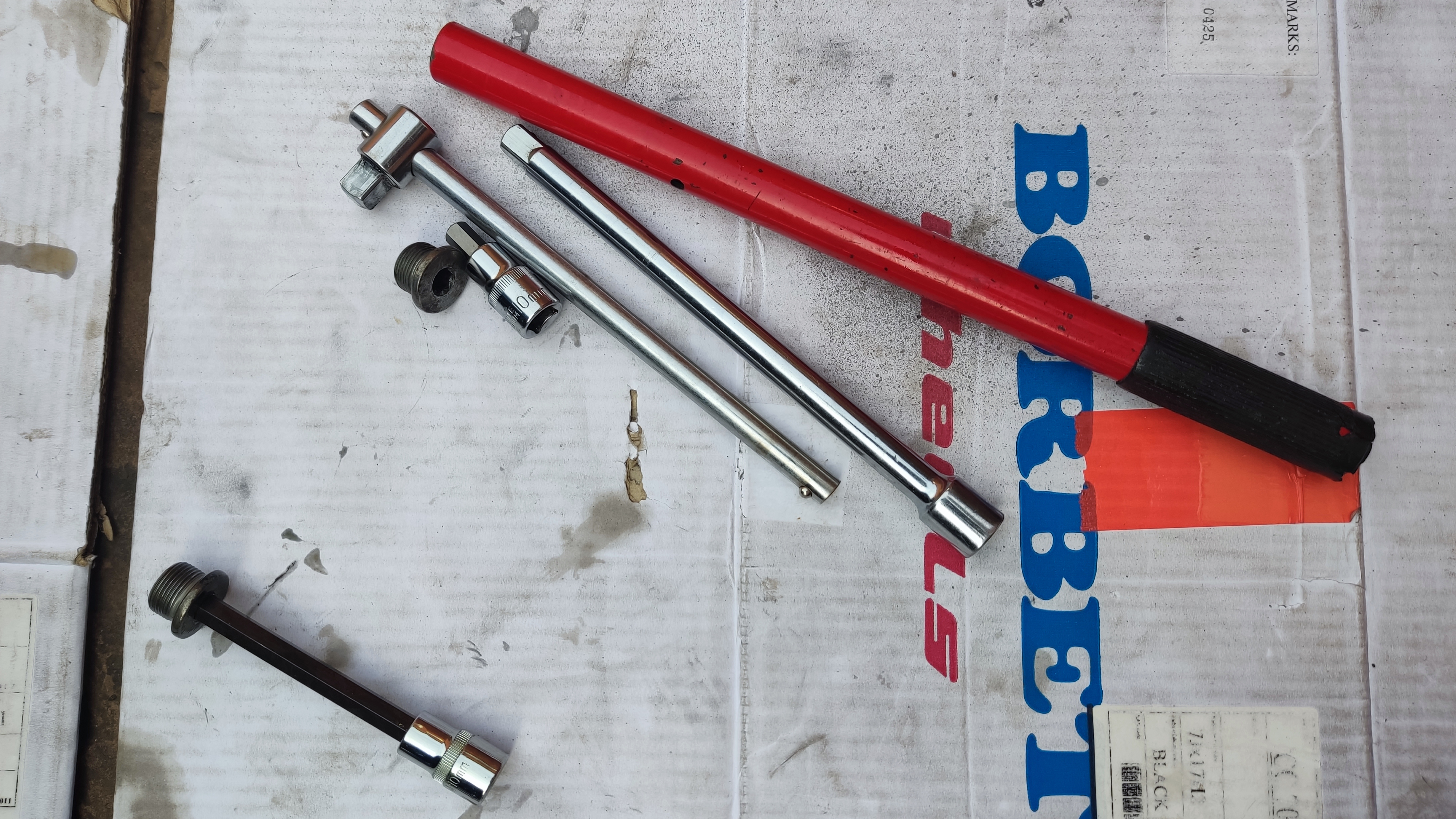

So, I've started doing a major service and just wanted to ensure the Gearbox fill and drain plugs are normal threaded. ie. Left to loosen - and not reverse threaded
I've put an extension on my 1/2" ratchet and even after some heat - the damn gearbox fill plug is not budging! .. even with a small breaker-bar.
I haven't even attempted the drain plug yet.

Same meaning as normal.... The release of the cap is counterclockwise

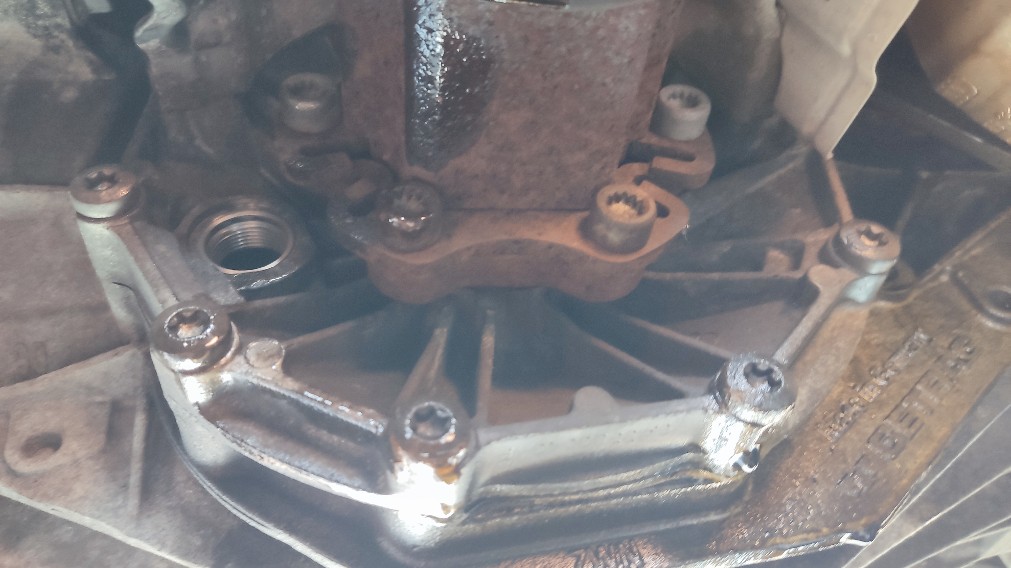

Post by r8wut » Sat Sep 09, 2023 10:27 am
yep, managed to get off the Gearbox fill plug - just required a little more leverage (counter-clockwise) , by way of extension bar.. was slightly tricky as not much room when performing on the 'ol driveway..
the drain plug was easy enough:
