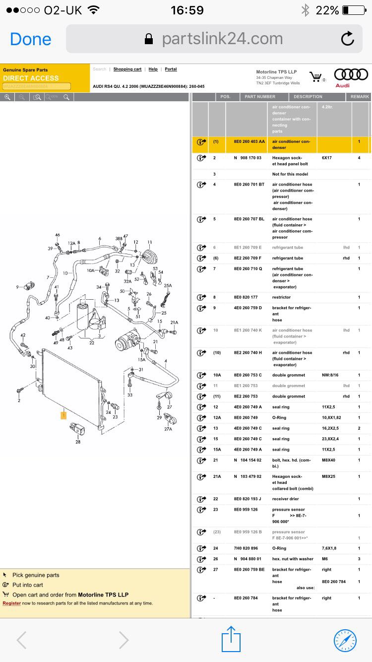

Good question, don't think so, looking at these parts pics from Audi UK (so assume RHD): (side fitting driver side, bottom fitting passenger)

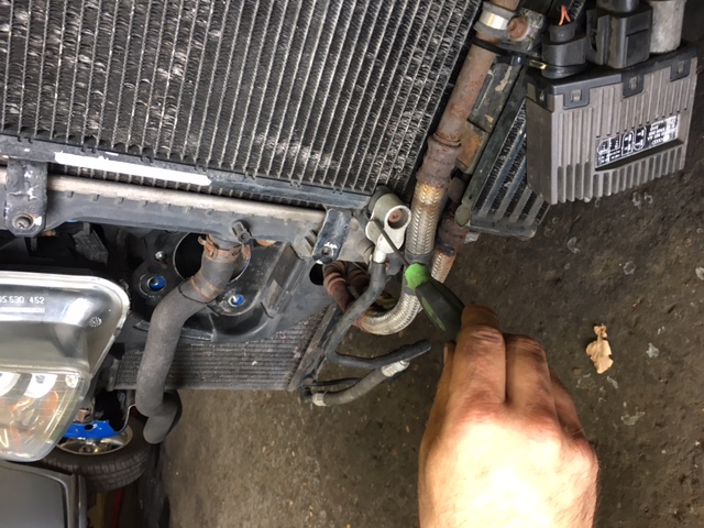

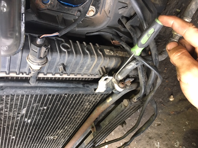

And this is the car: (note front fitting pipe on driver side, side fitting on passenger. can't figure out how to rotate the pics, sorry)
I went so far as to order a new condenser from Euro Car Parts, and it was exactly as pictured in the parts guide i.e. not a direct replacement for what I've got.
