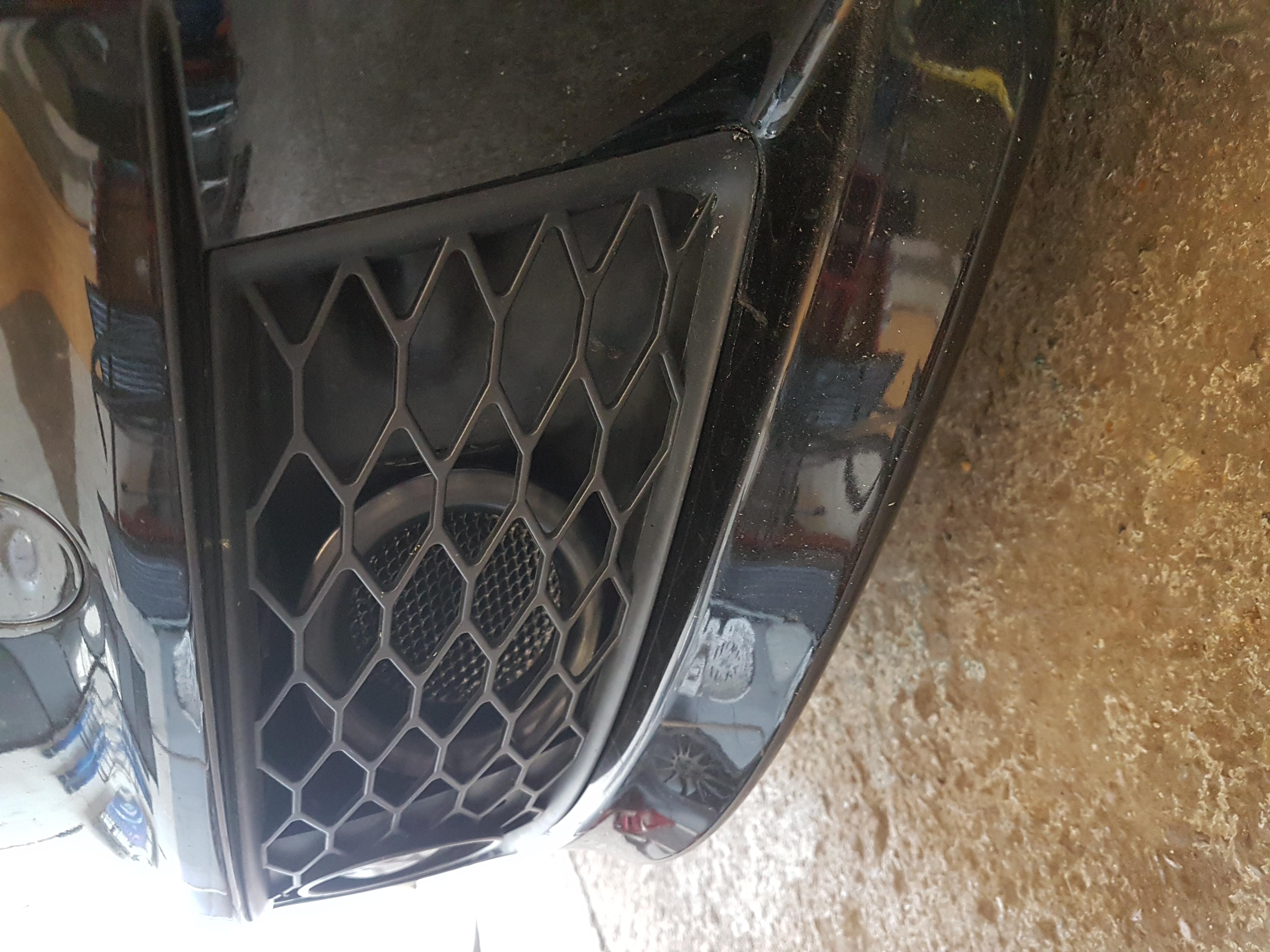

Fun and games
Posts: 120
Joined: Fri Jan 20, 2017 11:19 pm
Re: Intermittent Water Leak
Post by Fun and games » Fri May 19, 2017 8:58 pm
My finished example instead of replacing with another aux rad
