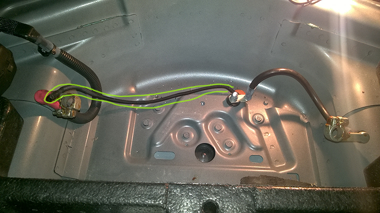

Does anyone know what the highlighted tube is? it comes out of the red/orange grommet on the right of the battery/sparewheel! well. but isn't connected to anything, couldn't really tell if the end of it had been snapped off of something.

The tube is a vent tube for the battery, the Varta one i bought had two plastic grommets, one on either side. After reading the instructions you are supposed to leave the right one in and put the vent tube in the other side.
It then vents any gas build up out of the battery and out the bottom of the wheel well.

ah ok, hmmm well it certainly wasn't doing that in my car lol. I'll check the new battery to see if it needs the same. thankyou.

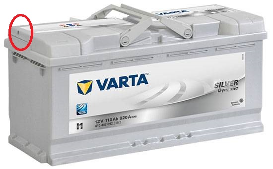

Post by daytonamart » Thu Mar 09, 2017 9:27 am
Here's the battery i got with the spec on the sides etc. The red circle is the left vent hole.
