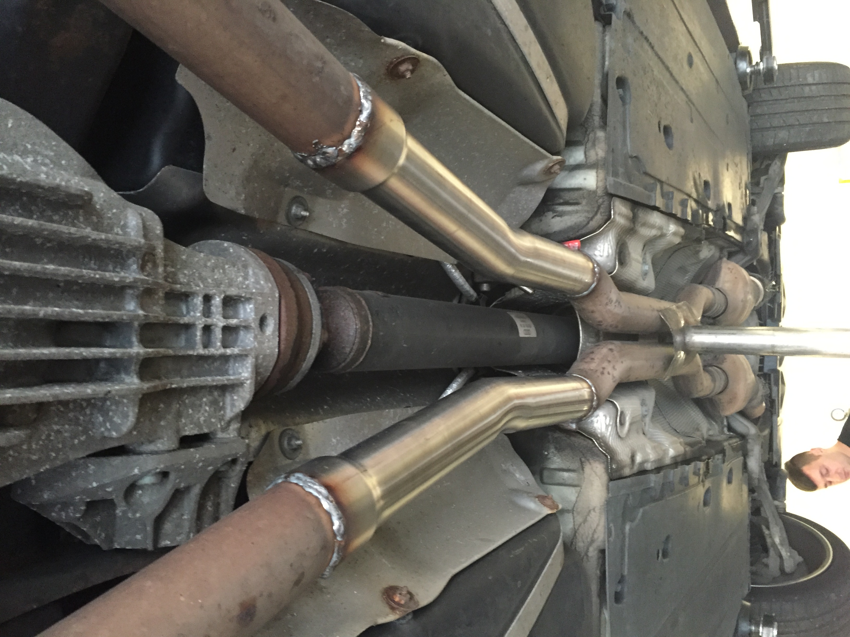

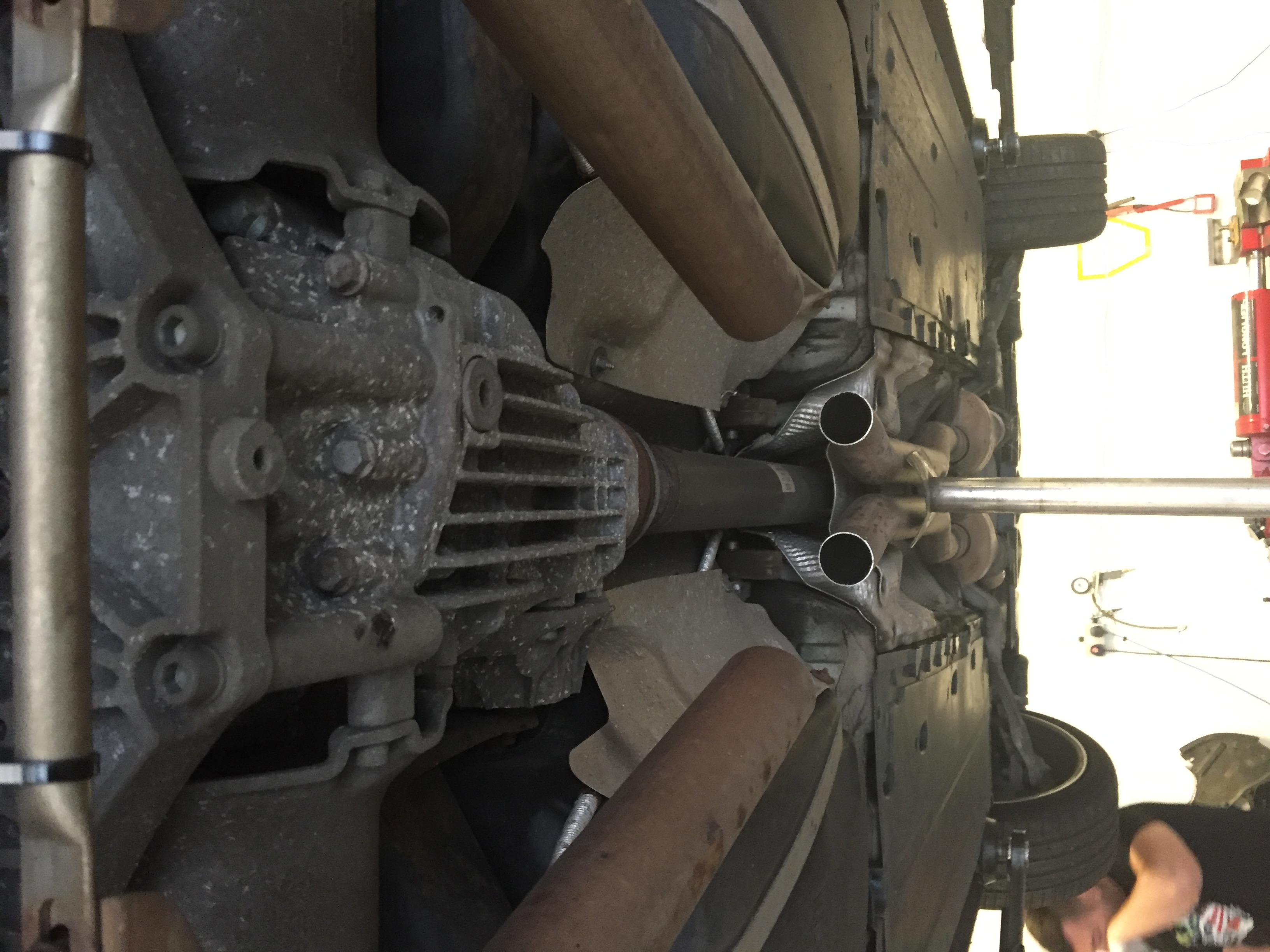

coffey555 wrote:
Tue Feb 28, 2017 3:05 pm
Just remove the centre silencers and replace with straight pipes for around £200.
Where can I get this done? Mrc? Jcweldfab? Etc etc.?

Post by jonytek » Wed Apr 19, 2017 1:20 pm
Are exhaust installer/center can do it and should't cost over £200. I used one of the chain companies and they did an ok job of it. Can't remember the name but I can check tonight if no one else beats me to it...

Post by jonytek » Wed Apr 19, 2017 1:35 pm
Here they are, I lose track of the UK workshops - https://www.longlife.co.uk/Longlife-Watford
Like I said, not the best engineers but they get the job done. Make sure they adjust the level of the back boxes/tips before they weld, mine are sitting slightly lower since having the work done...
Cheers for that... I contacted my local exhaust fabricators (not anyone that's been mentioned here) and they've quoted me £650 + VAT and they need the car for 2 days..
Seems a bit excessive :shock:

GT-steve wrote:
Fri Apr 21, 2017 5:36 pm
They have either misunderstood what you are asking or are on drugs! I've had whole exhaust made up at one of these places several times and it takes about 4 or 5 hours (single branch exhaust though). To cut out 2 bits of pipe and weld 2 straight bits of pipes in it's place is a simple job.
Did they get underneath and look at exactly what needs to be cut out?

Post by jonytek » Fri Apr 21, 2017 10:30 pm
Show them this.

Post by marc1 » Sat Apr 22, 2017 8:10 am
Will take about an hour. Maybe an hour and a half.

Post by marc1 » Sat Apr 22, 2017 9:02 am
Or just buy this and as them to cut your stock exhaust to fit it.
