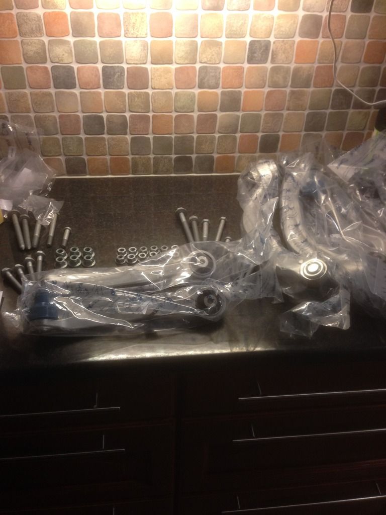

i ordered the complete suspension arms kit from kms on ebay, left spindle i found for bidding on ebay(brand new OEM) for very good price, right one i ordered fom my audi dealer.

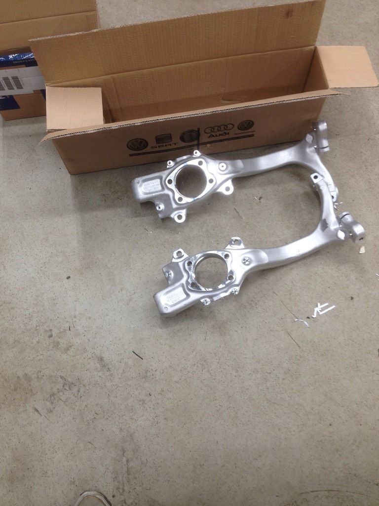

both spindles had a crack at the top mounting
