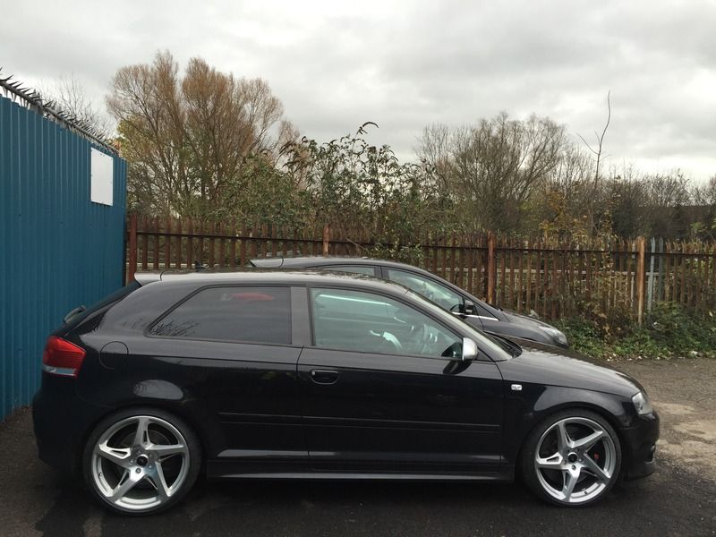

Starry can you tell me more about your S3 setup? Cheers.
The aftermarket wheels I fitted to my S3 which was using RS3 custom brakes actually touched so I installed 3mm spacers and they were not visible without removing the wheel. They are so thin that the wheels still has loads of hub to sit on and should cause no problems.
