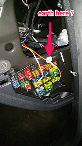

Hi guys I need a bit of help.
I'm installing a dash cam smart power device
It has 3 wires
Black - earth
Yellow - permanent power
Red - power when ignition on
Couple of questions
Where is best to earth it ? See pic - can I earth using the screw above the fuses ?
And which fuses are permanently on and which fuse goes on with the power?
See pic
thanks

Re: Ignition live wire
Yep, that would be a good earth.
On the Audis I tend to aim for the rear wiper fuse for the switched ignition power. I vaguely recall trying to use the horn first time I tried wiring a dashcam, but found that still worked after I turned the ignition off. There are a few circuits that work for a certain 'time' with the ignition off - electric windows for example.
Edit for clarity - the ones I've fitted to our cars simply power up the dashcam when the ignition is on
