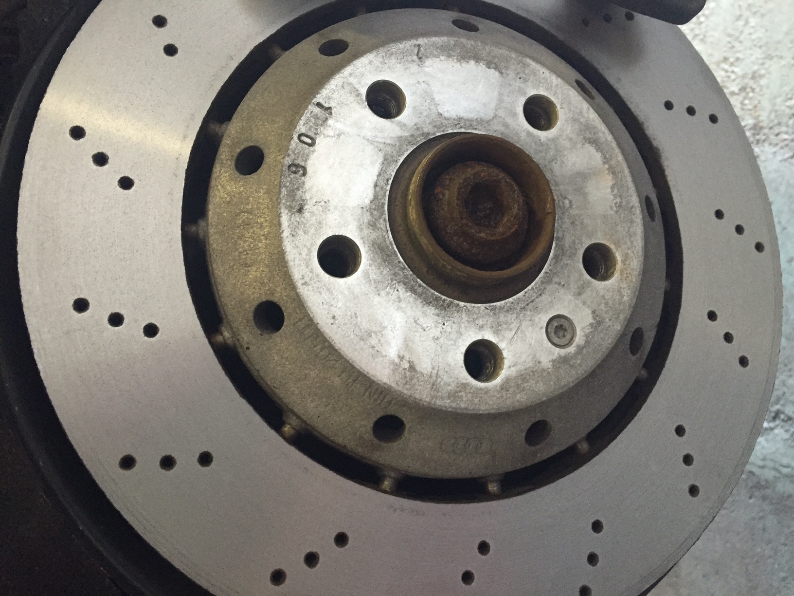

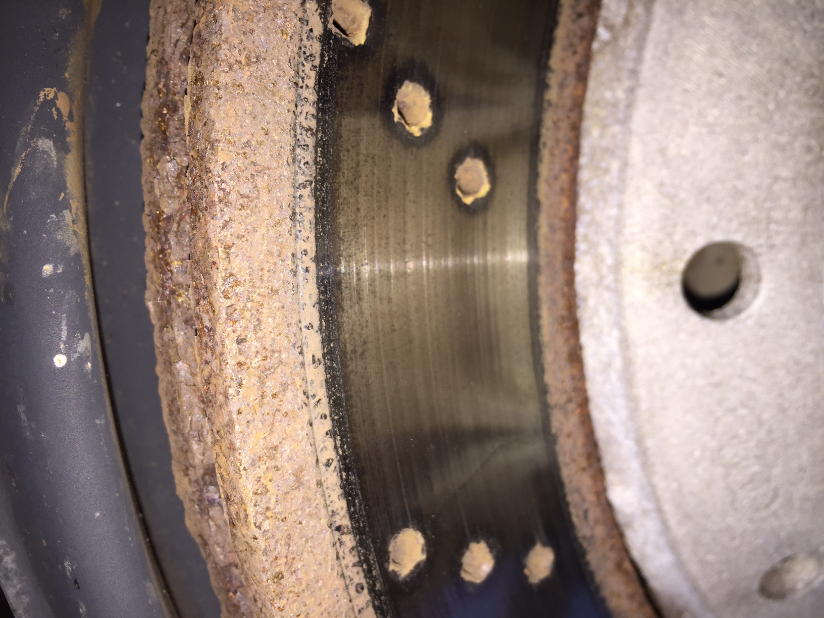

Before and after of the rears, will shoot the fronts tomorrow.

Blimey, great turn around. Those discs were in a bad way.

Did it have the wrong pads on before? Thats one hell of a lip!

Great looking job but more to the point, are they still over the minimum tolerance?
The RS4 discs are renowned for having a very small amount of wear before they fall below tolerance!!!.
think the fronts allow for 2mm wear (1mm on each surface) and the rears are less at about 1.6mm wear (0.8 on each face).
I'm guessing (hoping) the disc skimmer guy did check for min tolerance prior to skimming to ensure he was not taking off enough to take them below!!
Im not suggesting they will self destruct as soon as you go below as I know my fronts are bang on the limit and I have read of a few guys keeping them going for another 1mm of wear as they claim Audi's limits are too conservative!!
Just wanted to make you aware in case you had over looked this.

The pads were original so not sure why the lipped like that.
Thanks for the heads up Richie, the discs are on the limit after skimming, they lasted 33,000 miles using 2mm so if I can get 15,000 out of them they'll be above 31.5mm, not that out of tolerance for me. (famous last words as I leave the road at high speed in a cloud of broken disc induced tyre smoke)
