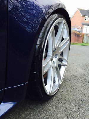

To further qualify, why I was asking about tyres.
I have the SS+ suspension option with standard 19" wheels. I then fitted H&R hub centric spacers to the car, 8mm to the front and 10mm on the rear.
With worn Goodyear Eagle F1 tyres I experienced light rubbing on spirited driving, once these were replaced with new Michelin Pilot Supersport tyres. I tried the spacers again and the rubbing has stopped. I guess the tolerance for tyre sidewall squidge whilst under load is now very small with spacers fitted. Michelin tyres I've found to have firmer sidewalls, which is a characteristic that I prefer and has also helped out in this scenario.
I don't necessarily agree with Covkiller's comments about not bothering with a standard car. Personally I think that the RS4 looks better for having spacers fitted and I have no rubbing now. Win, win.

I'm running 10mm Eibach hubcentrics all round with standard 19" wheel set up (255/35/19 Dunlops) and I rub over hard cornering and speed bumps. Revolution247 sorted me out with extended bolts too. My car stance looks awesome but after reading the above comments I'm wondering if I have a spring weakness issue?
Any ideas and I hope this helps with your spacer choice Ivan Good.
