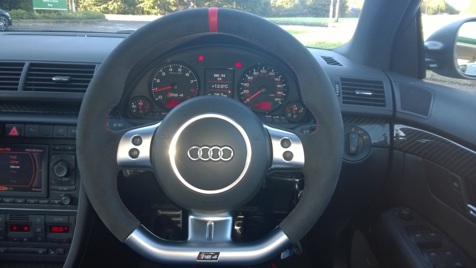

I've just had my steering wheel, handbrake and gaitor retrimmed (looks great don't you think... going for the red accents) however I thought when the wheel went back on the airbag light would have gone off (did when I had my seat belts rewebbed) or does it need to be reset with VAG?

Every time I've had a seatbelt warning light I had to reset it it with VCDS. Mine came on when I drove it with no passenger seat fitted. Even when I refitted the seat the warning stayed on. I'd asume it is the same for the wheel but only if you started the car when the wheel was removed.

When removing airbag's etc you should always remove the minus pole from the battery. This way you will not have the airbag warning light on either.
If the warning light is on a simple fault reading and reset with VCDS is enough. You you think the fault reading takes too long (it does take a while) you can reset the warning light straight in the steering wheel module.
