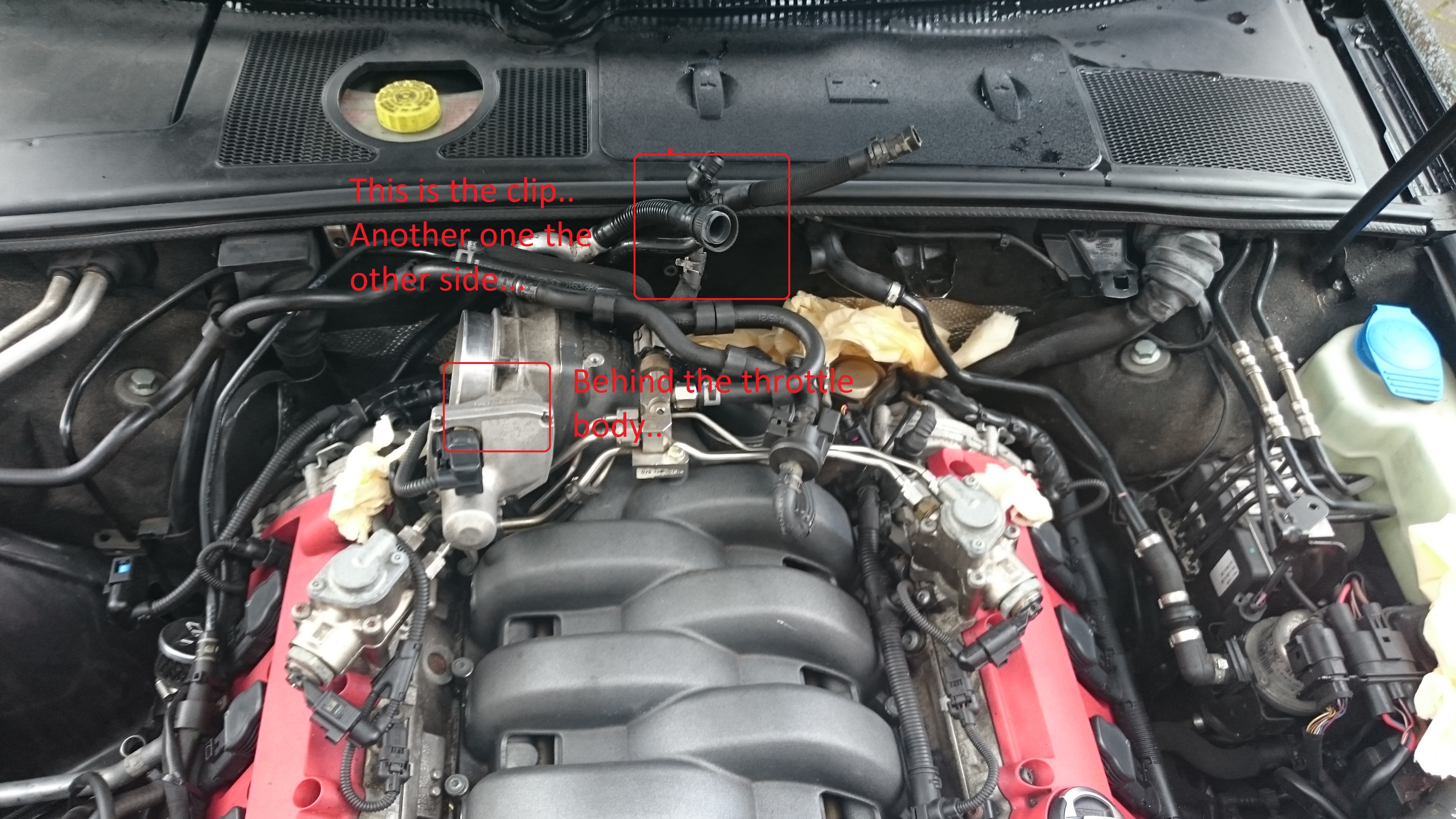

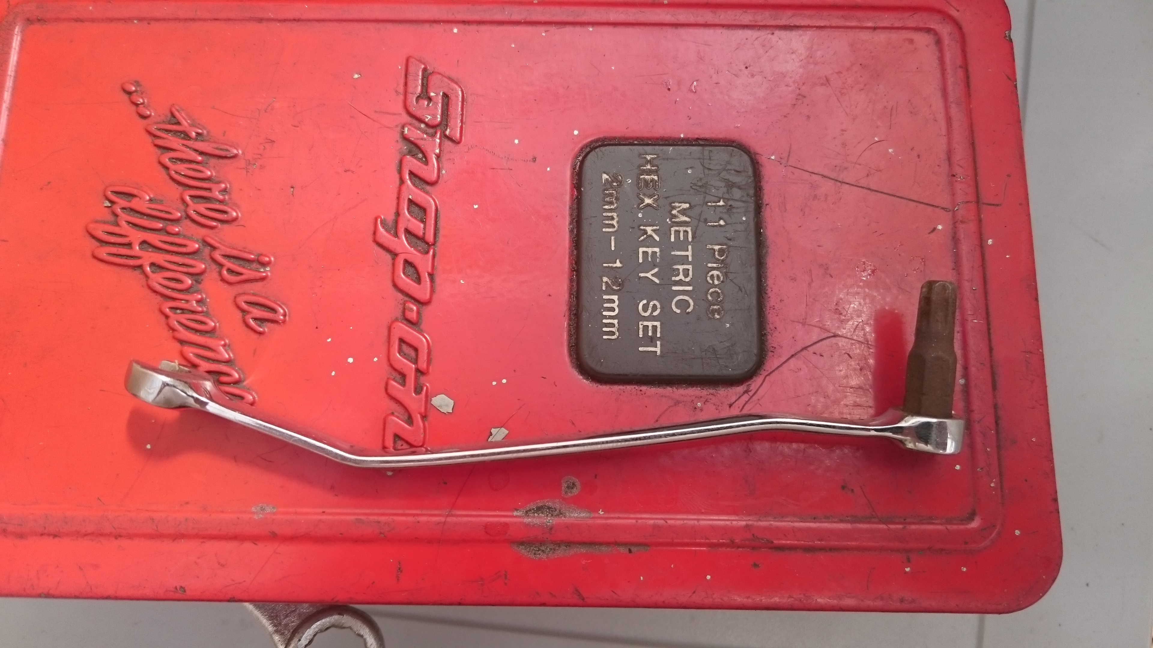

I then got a six mill spanner and put a t-30 torx head in the spanner only a cheap one from a screwdriver set as this was so much easier than anything else.. ( the spanner is bent from a previous RS2 issue... ( picture below.)
Then you can get to the 3 torx bolts holding the pcv to the engine. you should see they why you need to remove the black pipes from the gold bits,

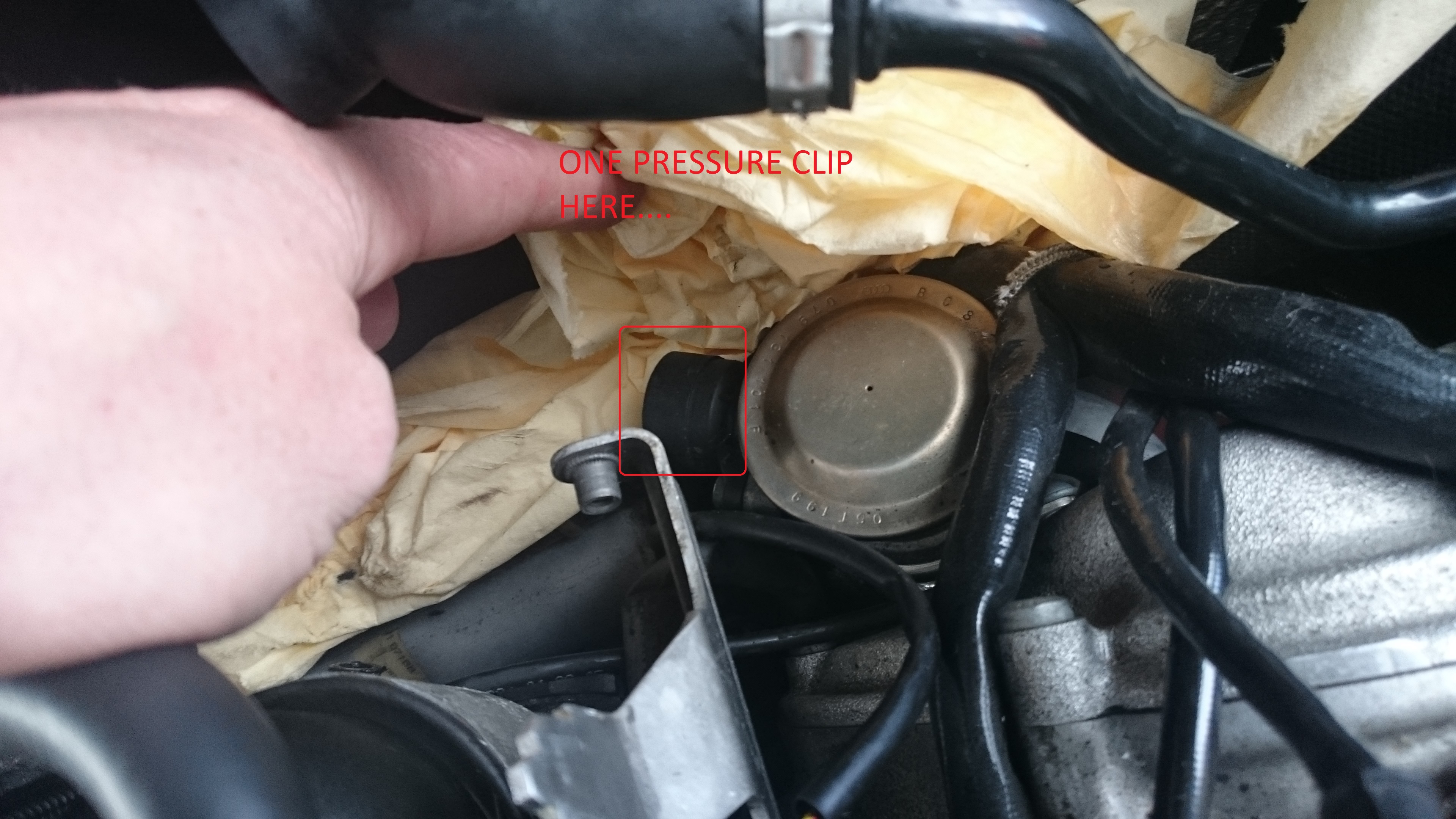

Once you have undone the 3 bolts the valve should slide of do not pull away as you need to remove a pipe from the bottom of it i used a screw driver to unclip the clamp one twist and it should pop open.. This clip should then go in the bin and replace it with a little jubilee clip. when you replace with the new pcv.

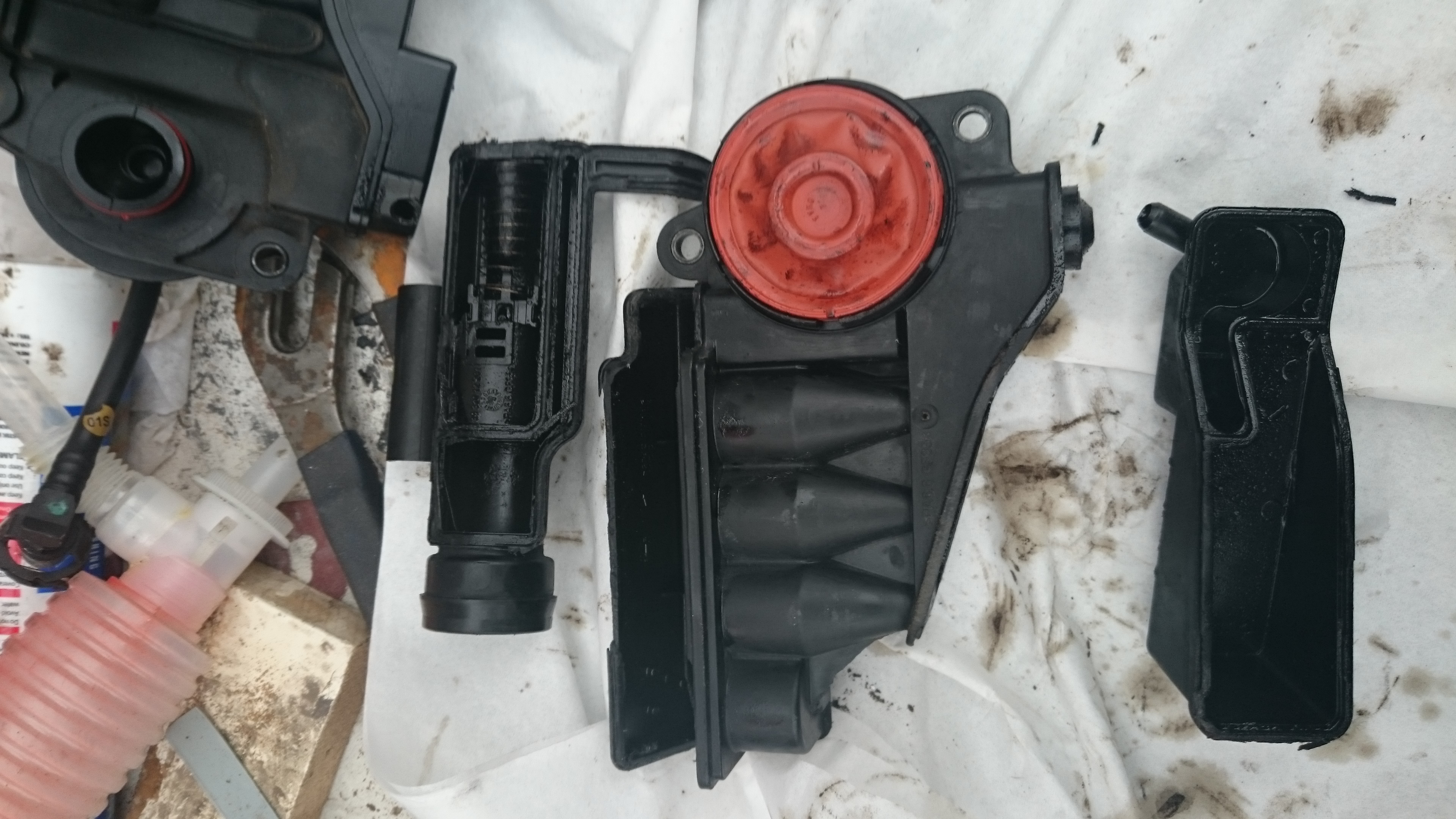

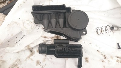

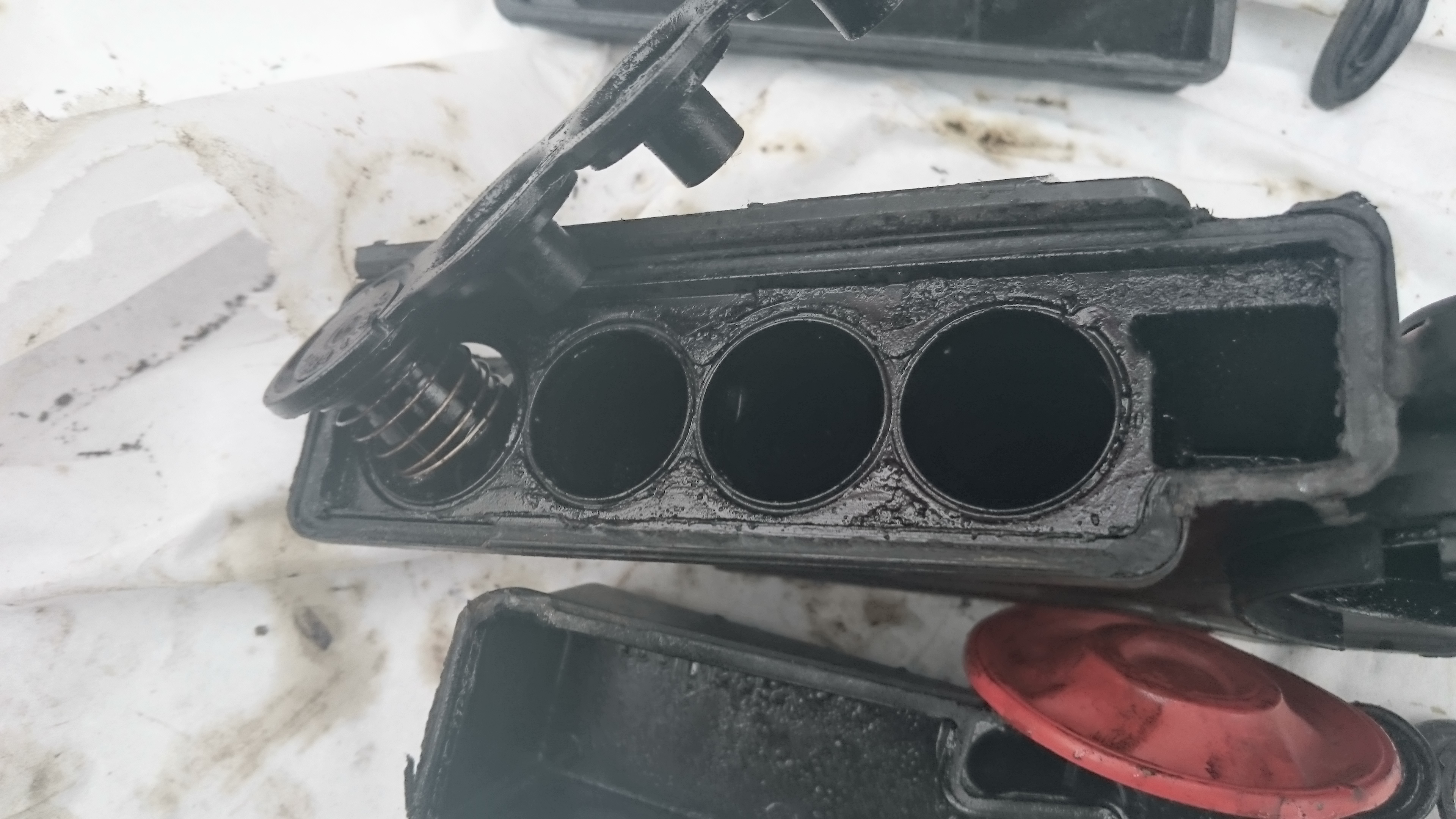

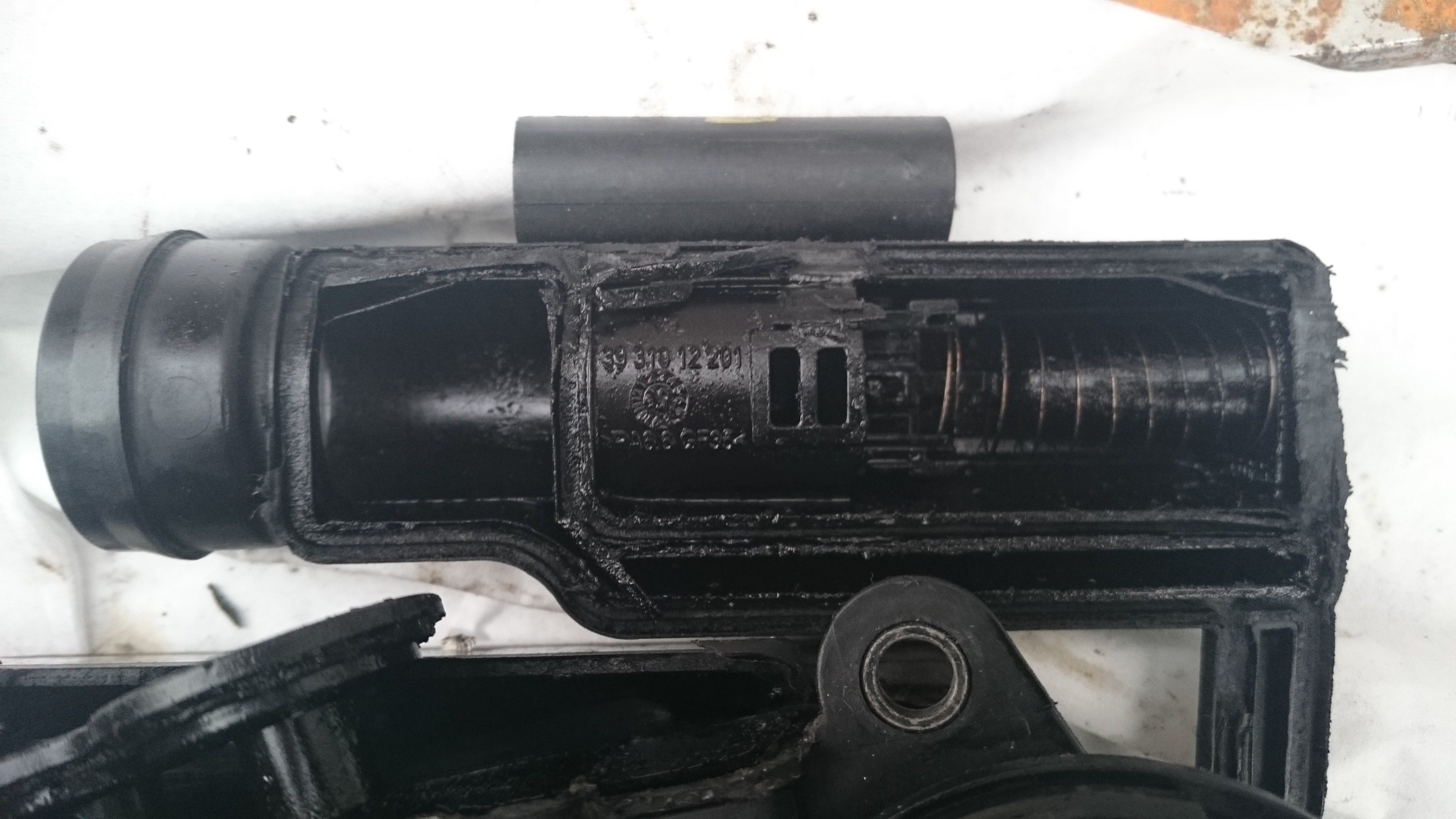

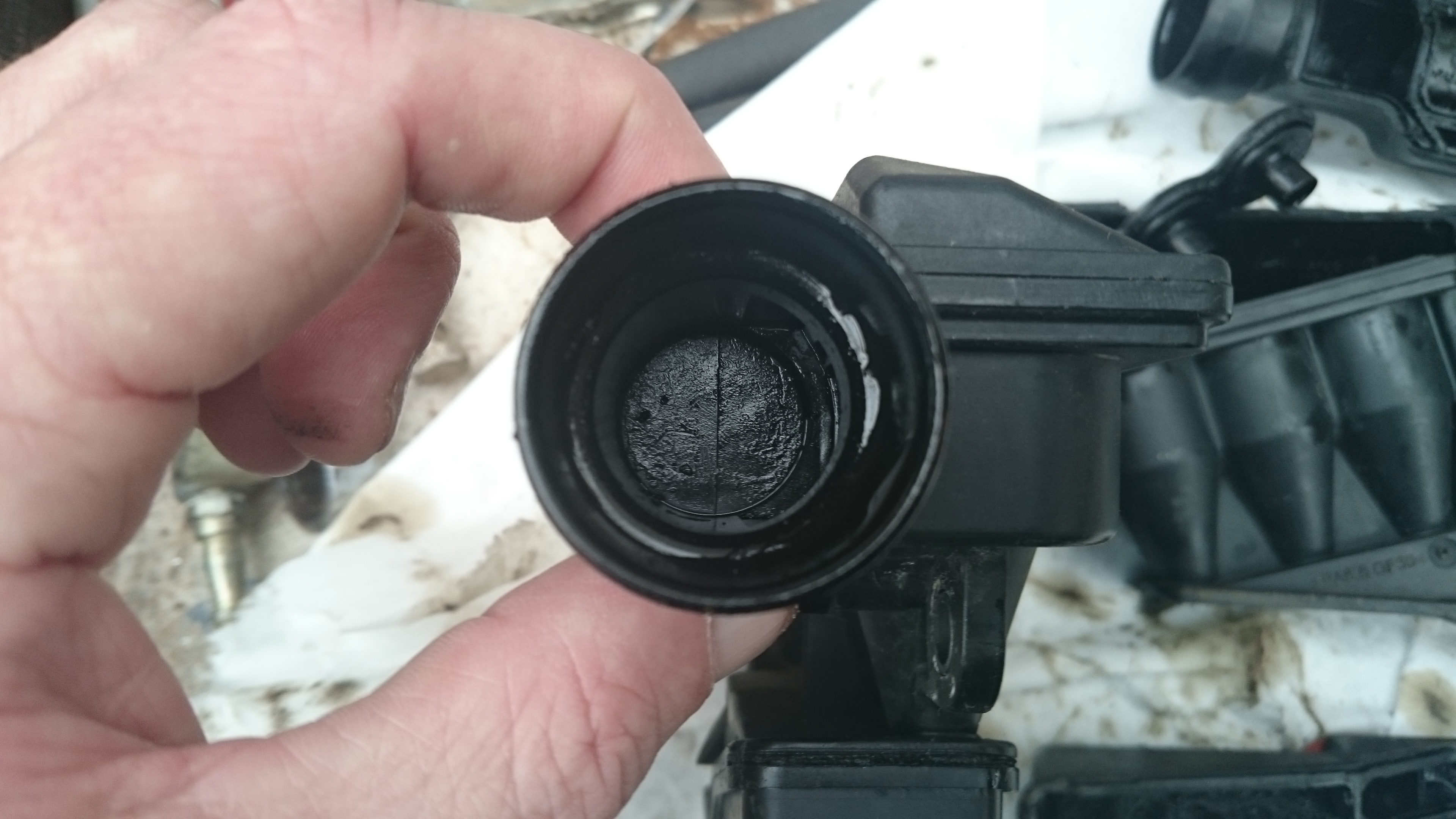

a few pics of the valve in bits..
this plunger was stuck solid.

Sorry for the late reply me taking the pcv apart was destroying it although you can clean it i imagine its one of them things that i imagine might as well be replaced.
