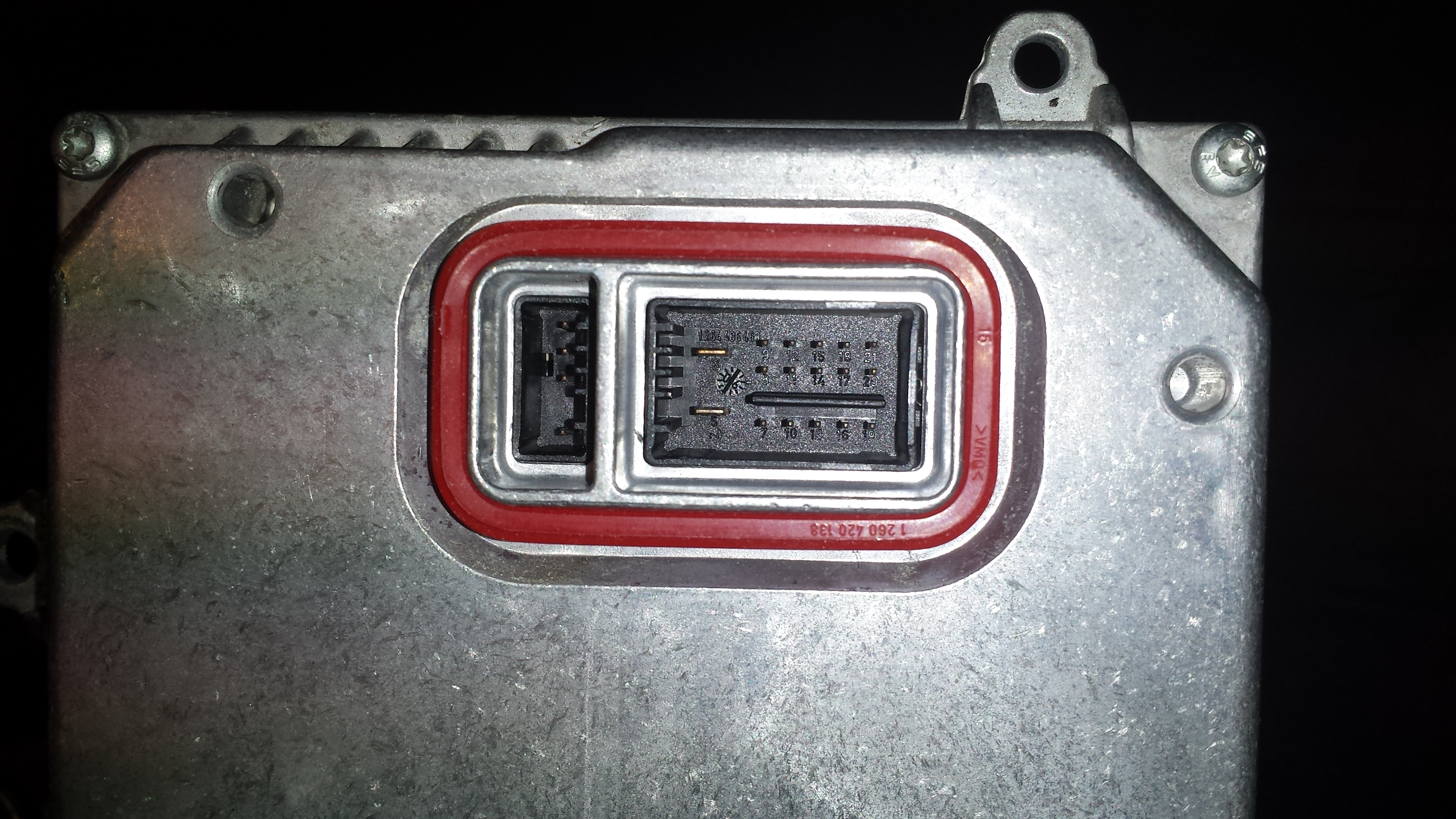

Hummmm, ok where are you based ( if local i will pop round) also I have a pair of ballast for a A4 unit that mighty get round the issue; The other option is to take you're unit apart and have a look at what's broke and I may have what you need to fix them or you strip the new unit for parts.
Re: Help!! Incorrect Headlight (w\Pics) !!!!
Thank you, located near Manchester. The complete black plastic frame around the xenon lamp has broken in several places, attaches to a combination of cogs, which I assume is the auto levelling mechanism. Im beginning to realise exactly how difficult sourcing a nearside headlight is for the 4
so may need to just order from TPS. Assuming I cannot order directly so will have to locate a motoring factor who does.

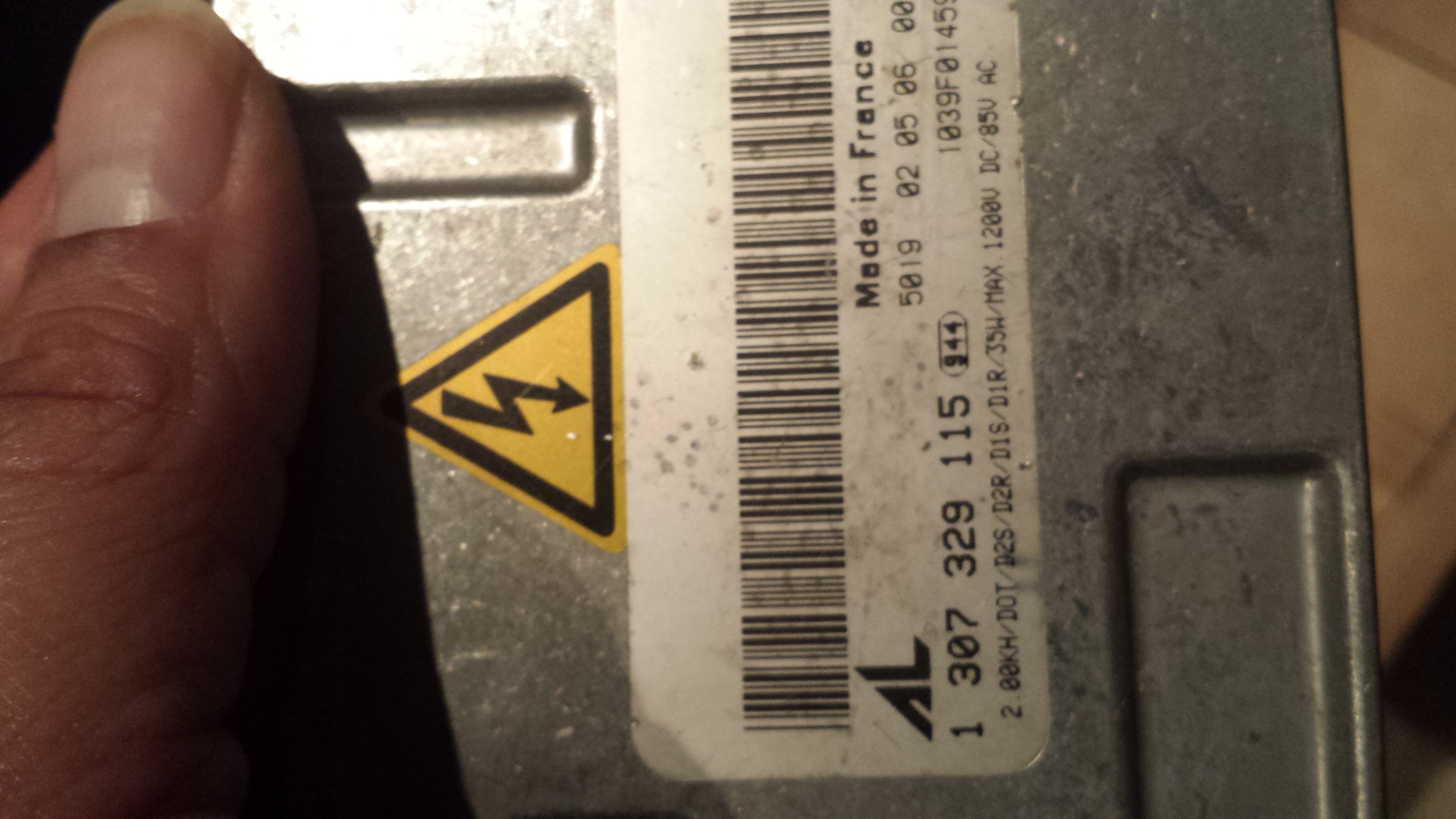

Just to add to this, I just gave them a call to see if they did ballasts incase that is what I needed. They can't match up the Audi part numbers to their system as they are Bosch units. Bosch don't make this kind of item any longer apparently. However he did say get some pictures from the unit itself and they might them be able to tell the specs and match up to something else they can supply. They were very helpful, so I wouldn't hesitate to use them.

Well if you do have the adaptive lights I would be somewhat surprised you never noticed them move plus I would have learned that none adaptive light still have the large ballast on the bottom.
Oh and I still think the smaller ballast might work or you might be able to use the frame holding the projector and fit it in to the RS4 housing (I know for a fact the mounting point are the same it's just the adaptive have additional workings on the frame but all mount the same.

None adaptive lights, I bought theses when I had my b6 looking to do a RS4 conversion on it I have a crap load of spares full set of doors plus another passenger door, two spare rear bumpers spare set of shocks and springs (one shock used now)
