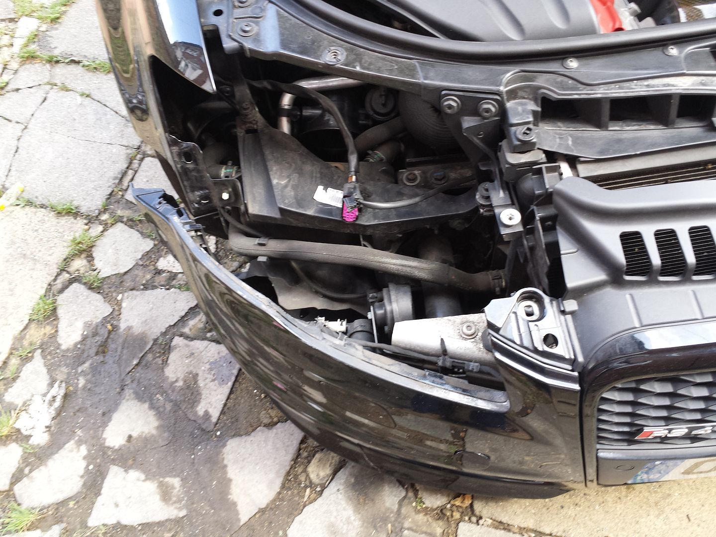

Well Saturday I had the bumper off to have a look at the coolest leak but alas all I could confirm was that it ain't the pipe work.
so while I was there I switched over the bumper,( still needs paint but better than what was on there and worked out what I need to do to take out the drivers side aux rad a fit a CAT.
Oil lines look ok but a painted them for more protection.
neilparf
Posts: 2908
Re: Leak front right from bumper
Post by neilparf » Mon Aug 11, 2014 1:16 pm
Nice! Oil ones look Ok. What do they look like connecting into the oil cooler? That's where the galvanic corrosion sill occur...

docurley
Posts: 1215
Post by docurley » Mon Aug 11, 2014 1:43 pm
neilparf wrote:Nice! Oil ones look Ok. What do they look like connecting into the oil cooler? That's where the galvanic corrosion sill occur...
I have to say they looked ok too but I did forget to coat them so thats another job for next Saturday/Sunday when I remove the Aux rad and fit the CAI
