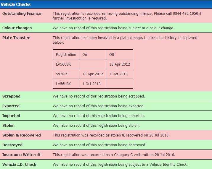

I HPI'd the car to be sure, and it registered stolen recovered and Cat C. He person seemed surprised by this. Anyway as it was well within budget I went to view today. Sadly I belive this car has been stolen recovered with front impact damage. The front slam panel is not straight or true near the wings, the lights seem mis fitted and part of the arch liner is very loose. It is fairly clean but I noticed he has not changed the Cat D remarks online

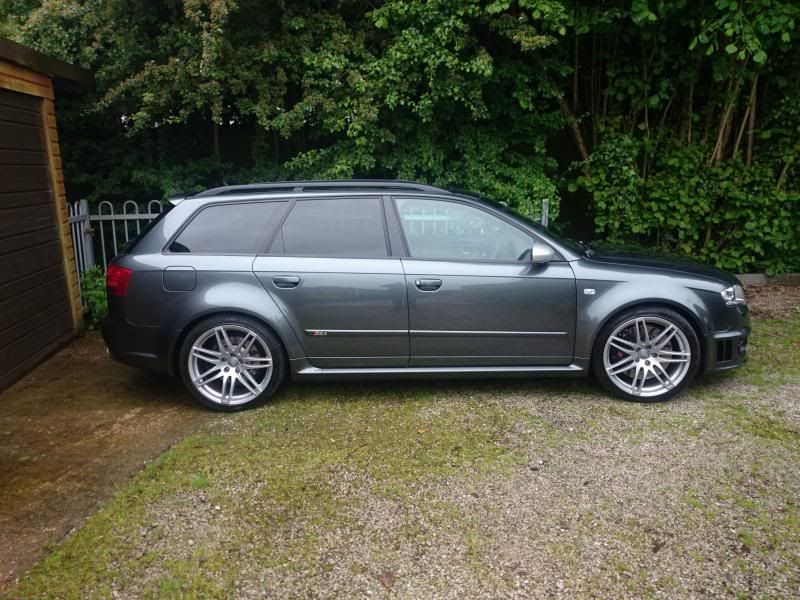

Do the wheels look wrong or is it just me or bad angled pics, seems a bit jacked up at the back for having SS
jonicox
Posts: 193
Joined: Fri Mar 22, 2013 1:43 pm
Re: Buyer beware ebay
Post by jonicox » Wed May 28, 2014 10:51 pm
kd wrote:Do the wheels look wrong or is it just me or bad angled pics, seems a bit jacked up at the back for having SS
definitely looks high at the back for SS. I can hardly get my hands on top of the tyres with SS. Also looks to have black optics, but a silver front grill. Smacks of a careless repair.
+1 on the SS on mine - this one looks way too high...

Looks well jacxked up on rear - i could not get my hand or fingers in top of mine with SS+

spikeyboy101 wrote:Looks well jacxked up on rear - i could not get my hand or fingers in top of mine with SS+
Neither can I ,mine looks as though as I already have Graham's two fat birds in the boot
Yeah that cars bouncing around all the time

Well I've asked eBay to tell the seller that it is a Cat C not D and they will either have to revise the listing or withdraw it.

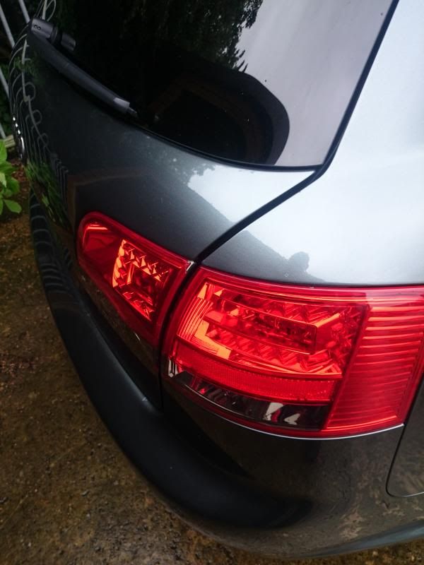

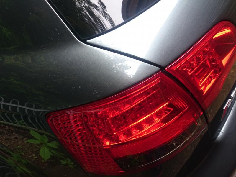

Rear lights lense is cracked / chipped
interior is not as clean as you would think for the miles infact its worse than the 77k mile car I just bought
He told me many times over that it went to audi to have parts put back on as they were stolen hence the cat D that turns out to a Cat C. I believe this is incorrect and a lie. The front slam panel is bent, take a look at where the wings meet the slam panel. These should be straight. They are not. The front head lights which were apparently replaced at Audi have different bolts holding them in place? I doubt audi would do this. i.e not all of them match

also the lines do not add up on the bumper. He tried to convince me otherwise. The lights overhang the car. The drivers side wing cover is lose? it just is not good
