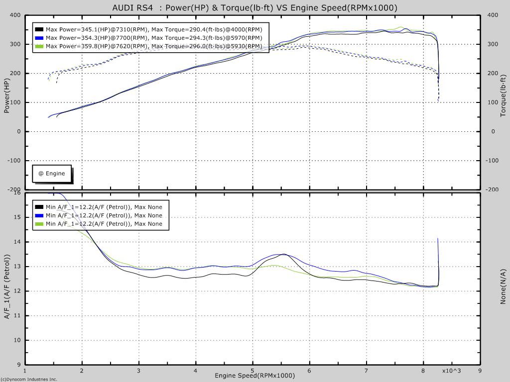

This is my first post to the forum since I got my first RS4 a couple of months ago - I ended up at Audi approved out of desperation and had to drive it up from London to Glasgow (what a drive :biggrin2: ). Anyway I also recently had the car dynod at Ecotune out of curiosity because although the car is fast I didn't feel like it was rapier fast at overtaking compared to my old scooby. According to Ecotune the car has 350-360bhp and they reckoned the loss is due to carbon as well (see chart below). They noted that it improved on each run whereas usually the first run is the best out of the three. Sounded amaaazing though. Suggested I go back to Audi with the curve to see what they would do with it... no prizes for guessing Audi's response! Would be very interested to see the results if you decide to have your car re-tested.

DaytonaRs4
Posts: 245
Joined: Fri Aug 09, 2013 10:42 pm
Re: massive power loss :(
Post by DaytonaRs4 » Sat May 31, 2014 5:46 pm
Get it cleaned and deflapped at autohaus buddy. Davy will sort it out for you. I think i was £750 for clean and deflap
