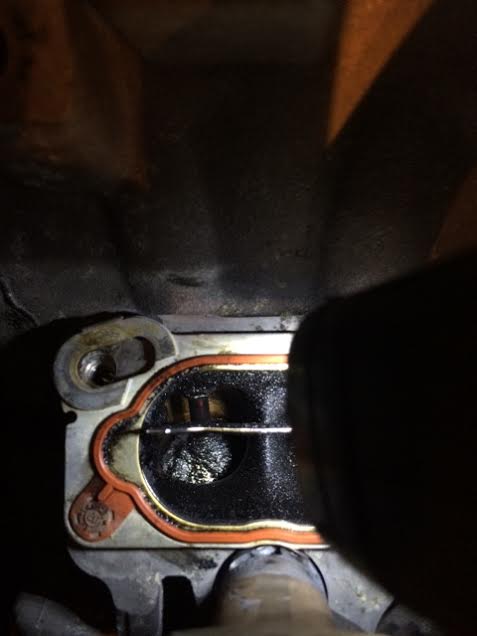

Visit 3: 11 hours labour and told me it’s an issue with the valve seals (pic attached) and to get rid of the car asap. They flushed the engine out twice and put some oil seal re generating fluid into the engine and sent me on my way. (Another £400 + VAT) After only covering about 12 miles I noticed some smoke and burning oil smell coming from under the bonnet to took it back and apparently they hadn’t sealed the sump plug correctly and it was dripping onto the exhaust.

you haven't got leaky valve stem oil seals all rs4's valves look like that, its carbon build up do a search on here its normal.
the second place didnt sound a lot better, regenerate the inlet manifold???lol
your problem sounds like a broken manifold flap position sensor on bank 2, you certainly dont need a new manifold.

You have carbon build up and potentially a vacuum issue.

As above. Sounds like either a vacuum issue (v common) or a stuck manifold flap.
When this happens the engine will get around 270ish bhp.
Also a brand new manifold from a dealer is 1600 supplied and fitted.
It's not a new manifold - a decent garage like mrc will simply remove the flaps and remove the error checking from the Ecu. Whilst te manifold is off you might as well go for a second clean, new vac one way valve and maybe a ported manifold (not expensive as done in an exchange basis.
