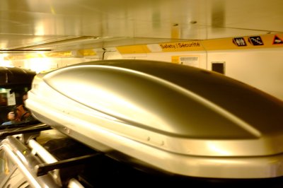

Well that pic is of my old RS4!
I used to run a Kamei Corvara roof box with the Whispbar bars no problem

Not sure if this is much help.
I have the square-section Thule roof bars and bought a Thule roofbox for skis & snowboards etc.
I didn't measure anything, but luckily it all fitted underneath the 1.85m limit anyway, just about! Maybe six inches to spare between the top of the roof box and the ceiling of the Eurotunnel carriage.
This post would be more useful if I could tell you which model of roofbox I have, but I don't have access to it at the moment.
Looking at the Thule website, I think my model is a Thule Motion with the dual-side opening.
