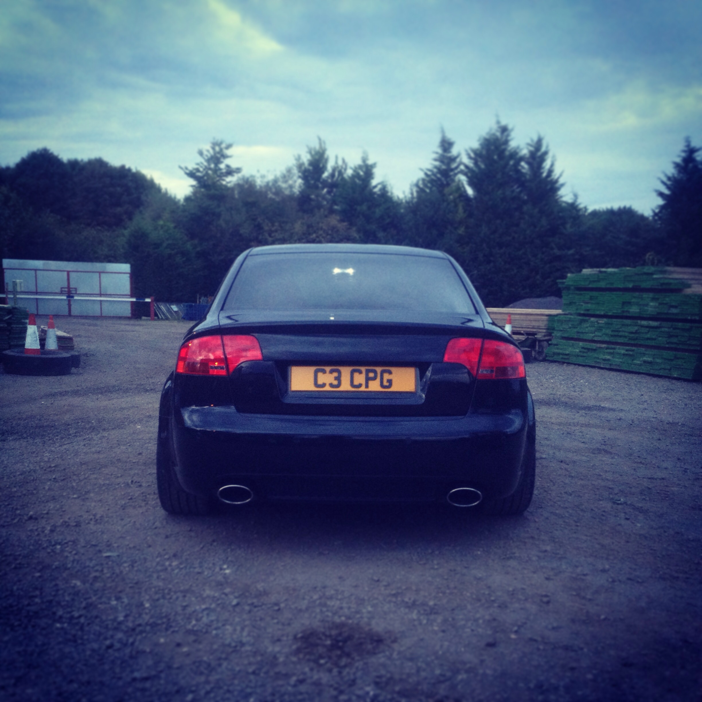

Only got pics with only the rears on here as haven't took any new ones yet! No wobble at all and never actually measured the ride height but I know the springs drop them around an inch and a half lower! Looks just right tbh. Considering the difference in price compared to coilys!
