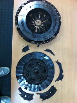

Mine went on lap 25 braking into the hairpin at donnington. No warning, no noises, pedal went to the floor and wouldn't come back up. Full replacement £2k! :biggrin3:

Post by topgun35 » Wed Jun 26, 2013 5:41 pm
Like this!

Damn thats a right mess.

Post by S4Player » Wed Jun 26, 2013 7:29 pm
Hahaha that clutch looks the same as what my Sachs one ended up like
