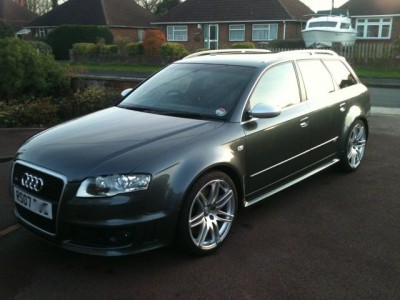

Had the car for a little over a year and 10k trouble free miles, an unmodified 07 Daytona Avant with 80k and the dreaded DRC failure has finally happened. A little research and thanks to this forum, I went to Rob and Camberley Audi, (in preference to my local main dealer in Basingstoke where I last got it serviced) and received the excellent and knowledgable service reported by many in previous posts. Rob managed to secure £300 goodwill against 2 failed shocks, so good news, if you have an Audi full-service history then it appears that Audi are still prepared to help, Rob indicated he could have got more if the mileage was lower. Unfortunately for bank balance both hydraulic pipes had seized to the shocks also required replacement which wiped out the effect of the goodwill - such is life. At least the other 2 shocks checked out fine so should be DRC problem free for a while now and the car is back to its usual self ie brings a smile every time I drive it. I also got a Technician's comment of "nice example of RS4" on the paperwork and Rob said the guys don't give those out lightly so left feeling surprising smug given the hit I had just taken on the c card. Maybe that was the idea to cushion the blow! Anyhow, a recommendation to add to the collection for Camberley Audi.
