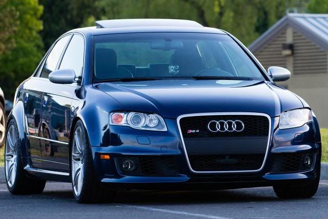

I switched to 275/30ZR19 PSS's and feel they are the perfect fit for our cars with absolutely no rubbing. Car is lowered on H&R springs and has 8mm H&R wheel spacers in the picture.
2007 Mugello Blue RS4
Re: Will 265/30/19 rub?
Cool. Did you try them without the spacers at any point?
Yes, and no issues. Spacers were added for looks.Shoppinit wrote:Cool. Did you try them without the spacers at any point?
That pic is just what I wanted to see, I've just orderd 8mm spacers, and I'm running 275's with kw'sI switched to 275/30ZR19 PSS's and feel they are the perfect fit for our cars with absolutely no rubbing. Car is lowered on H&R springs and has 8mm H&R wheel spacers in the picture.
That looks the daddy
Looks spot on -Boosted-, and I like the cheeky GoPro too
