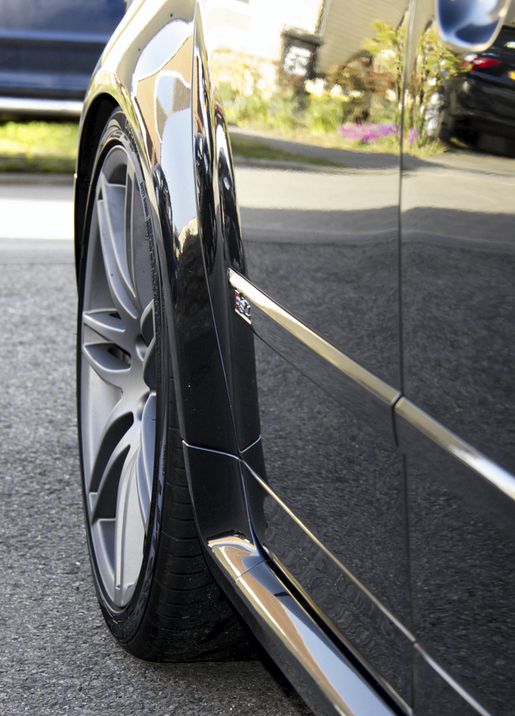

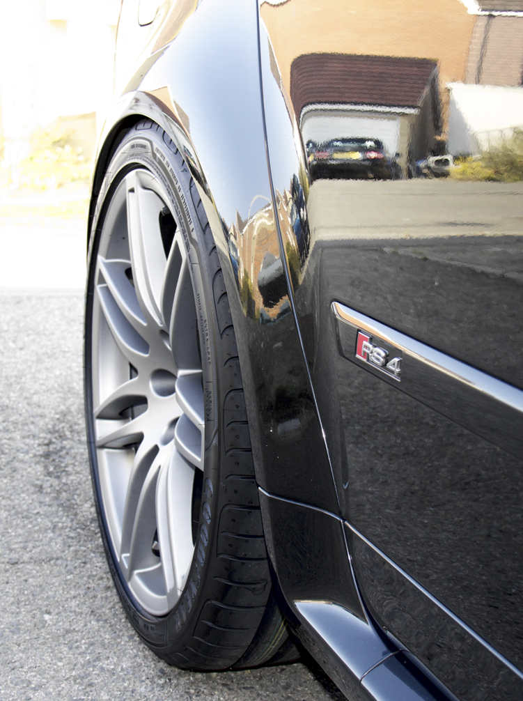

Just a quick post for reference really, I went from 275x30 Vred's today to 255x35 Goodyear's with 8mm spacers. Thought those who where considering it would like to see before and after pics. :thumbs: to Event tyres for fitting and :thumbs: to virdee for the spacers/re-sized bolts including lockers. Amazing what 8mm will do and from the back the car's looks much better - KWv3 coilovers next week :biggrin2: more pics to come
Cheers.
Kev.
Before [ 275x30's ]
After [ 255x35's ]

looks spot on.....are you going lower on the v3's ?

Looks awesome!
Today I had to change my order from 10mm H&R spacers to 8mm because apparently they no longer make the 10mm with the 150mm hub diameter.
Your pictures definately reassure me that 8mm and 275/30 v12 tires will look great.

There seem to be a few brands doing 10mm hubcentrics still, but those 8mm's are looking pretty good up rear.

Uhm - :o I would double check your figures as 275x30 tyres are 20mm wider and with 8mm spacers you are likely to go beyond the wheel arch.
I originally wanted spacers with my 275's and Virdee [a spacer supplier/fountain of knowledge here] in as many words stopped short of not selling them to me.
I had a choice of 275's with no spacers or 255's with 8mm spacers to go with my setup especially as I am going to KWv3's
I would strongly advise you give him a call - I am sure he would not mind giving you the correct advice.

I am amazed at how much 8mm a side can totally change the way the car looks :bowdown:

It doesn't look so much as detailed but just very clean, but Kev your arches look huge in that first pic!!!!! (that's huge in a good bulbous way!)
275 and 8mm spacers might be too much, 275 and 10mm is defo too much as I said in a post earlier today as the tyre is 20mm wide (10mm on inside and 10mm on the outside) added to a 10mm spacer is the equivalent of a 20mm spacer with the standard tyres and that is just too much with any weight in the back.
