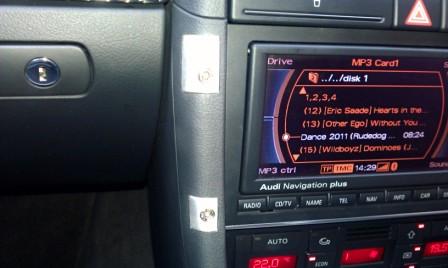

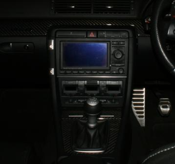

I removed my phone cradle and made 2 aluminum sections out of 10mm thick alloy plate, shaped they the same as the centre console and rubbed them in 1 direction with 400 grit to give a brushed look, then polished 2 m5 cap screws and fixed in. The photos dont do it justice but when I ask people they think they are ment to be there.

androidmarrs wrote:.. The photos dont do it justice but when I ask people they think they are ment to be there.
Definitely needs better photos in that case :-)
I believe replacement consoles can be had new for 130 quid and it's 3hrs of labour to swap them (going by what I've been told whilst looking).
androidmarrs
Posts: 105
Joined: Sun Feb 12, 2012 8:43 pm
Re: Removal of phone cradle
Post by androidmarrs » Mon Jan 07, 2013 5:50 pm
I will try and get a better photo during the day without the flash but will not be home for another week as im offshore the now.
