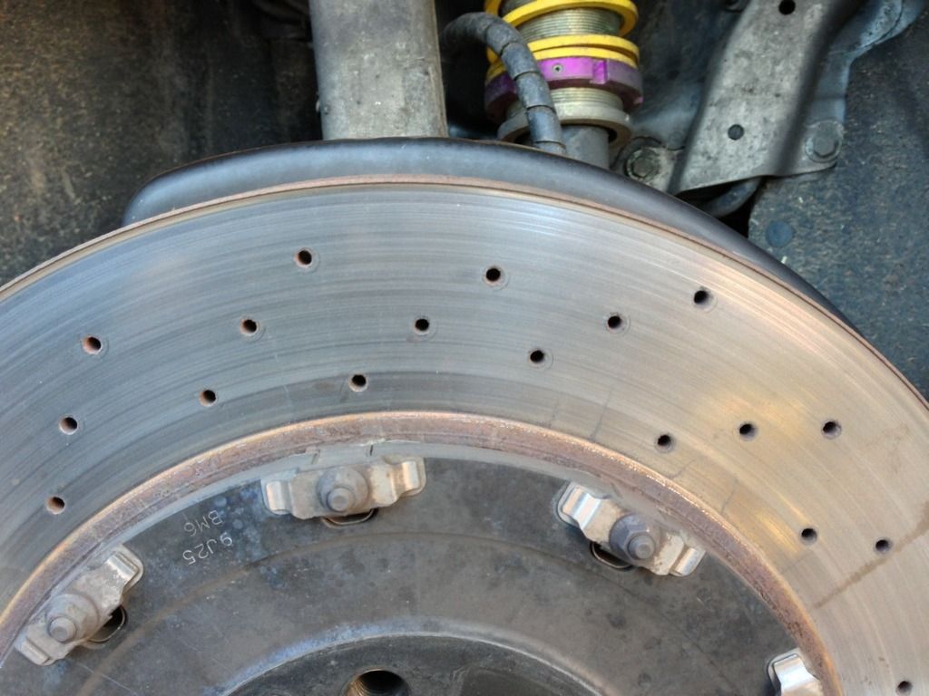

Ok so how the day went...
took off calipers and drilled out all the clogged dust in the holes of my disks
before...
after...
Calipers off the pins knocked out nice and easy and the pistons pushed back nicely with the help of a peice of wood and a crow bar off the car with pads in place which was the first obstacle that went nice and easy
rears were all done and hoses fitted and got onto the fronts which didnt go as easy! first of all the standard hoses have a 90 bend in them where it meets the caliper so i though ok i can get around that i have bits to make what i need so i did...
all fitted up fine and connected the hoses and checked lock to lock to make sure all was ok and when on full lock the hoses are to short and pull on the copper pipe so not happy and im going to contact HEL in the morning about it as searching the web they are aware of the problem but seems they have not accommodated for all there customers.
what they should be like
and what i have
as you can see i am missing the grommet to but having the reputation they have im sure they will sort it out! for the time being i have put the standard fronts on! just took it for a drive and its cleaning up the disks nicely and the faces are almost flat again after the padgids still with 5mm on ruined the look of all 4. No more pictures as it was dark when i finnished up but if your not happy with your brakes it a route i would recommend going.
