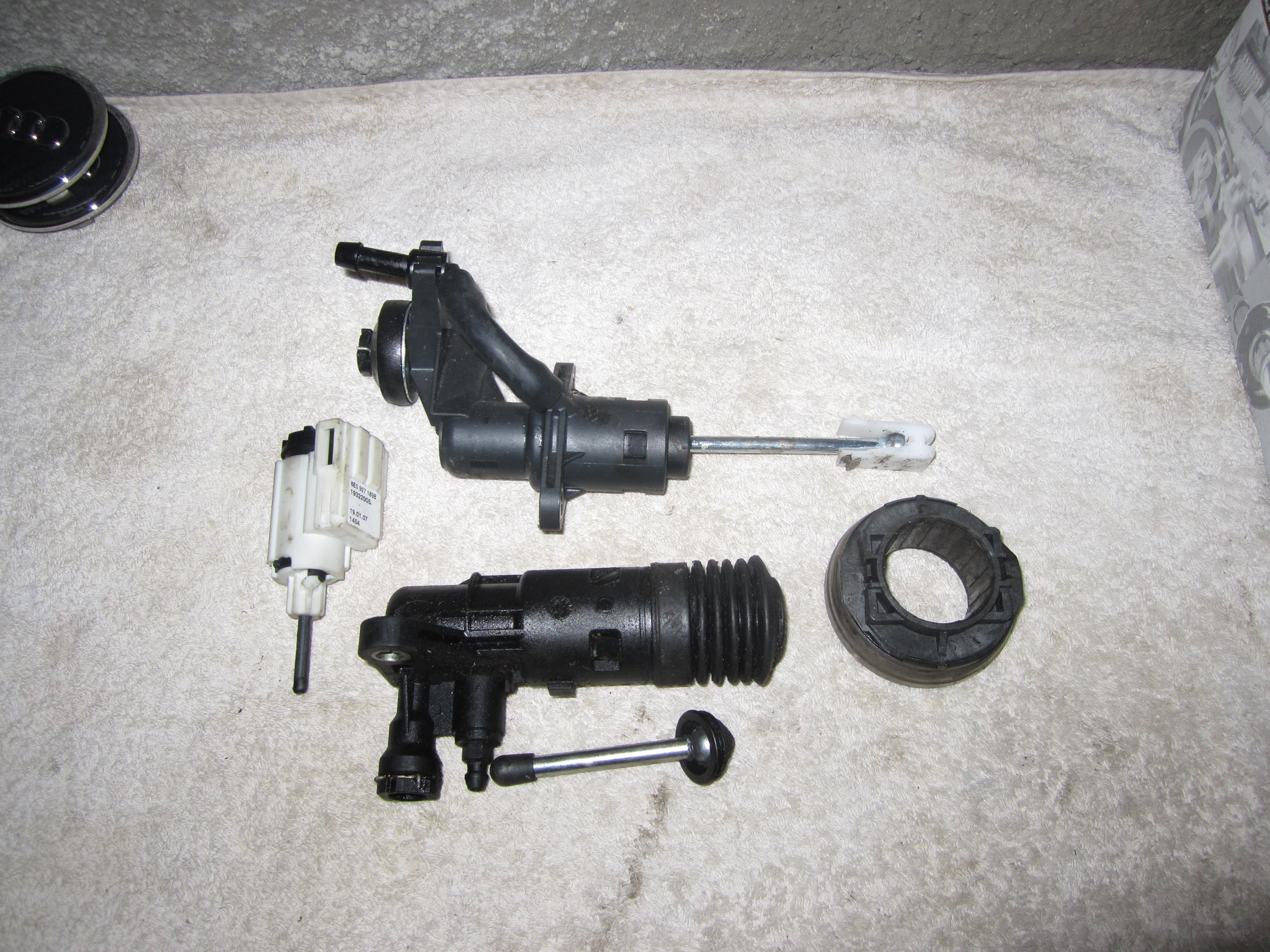

So it was out with the gearbox £££££ !!! I'm still not sure what the main issue was, with my broken French and the dealers broken English, but they replaced a few bits related to the clutch / gearbox, see photo attached. I also had them replace the clutch return pipe, pressure plate, friction plate, pressure plate bolts and the release bearing as a precautionary measure. I was also going to get them to replace the flywheel at the same time but after inspection they said it was in good condition and didn't need to be done, I hope it doesn't come back to haunt me!!
If anyone can identify the parts in the photo It would be much appreciated, i know the one is the release bearing, so just the other stuff.

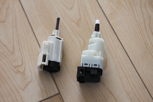

One looks like a solenoid (reverse gear lockout?) and the ring looks like the part Arthur points to as the source of the sticking clutch pedal issue.
Re: Difficulty getting into gear??? Update!!!!
Master and slave cylinders

+ the switch on the left is a clutch switchDal wrote:Master and slave cylinders

F@tBoyF@t wrote:+ the switch on the left is a clutch switchDal wrote:Master and slave cylinders

F@tB@yF@t,F@tBoyF@t wrote:+ the switch on the left is a clutch switchDal wrote:Master and slave cylinders

Cheers for the identification on the parts too folks!!!
