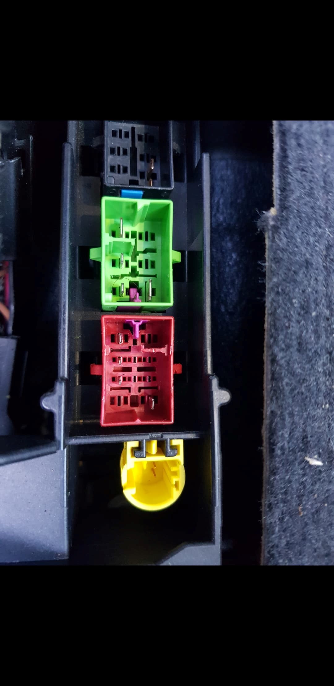

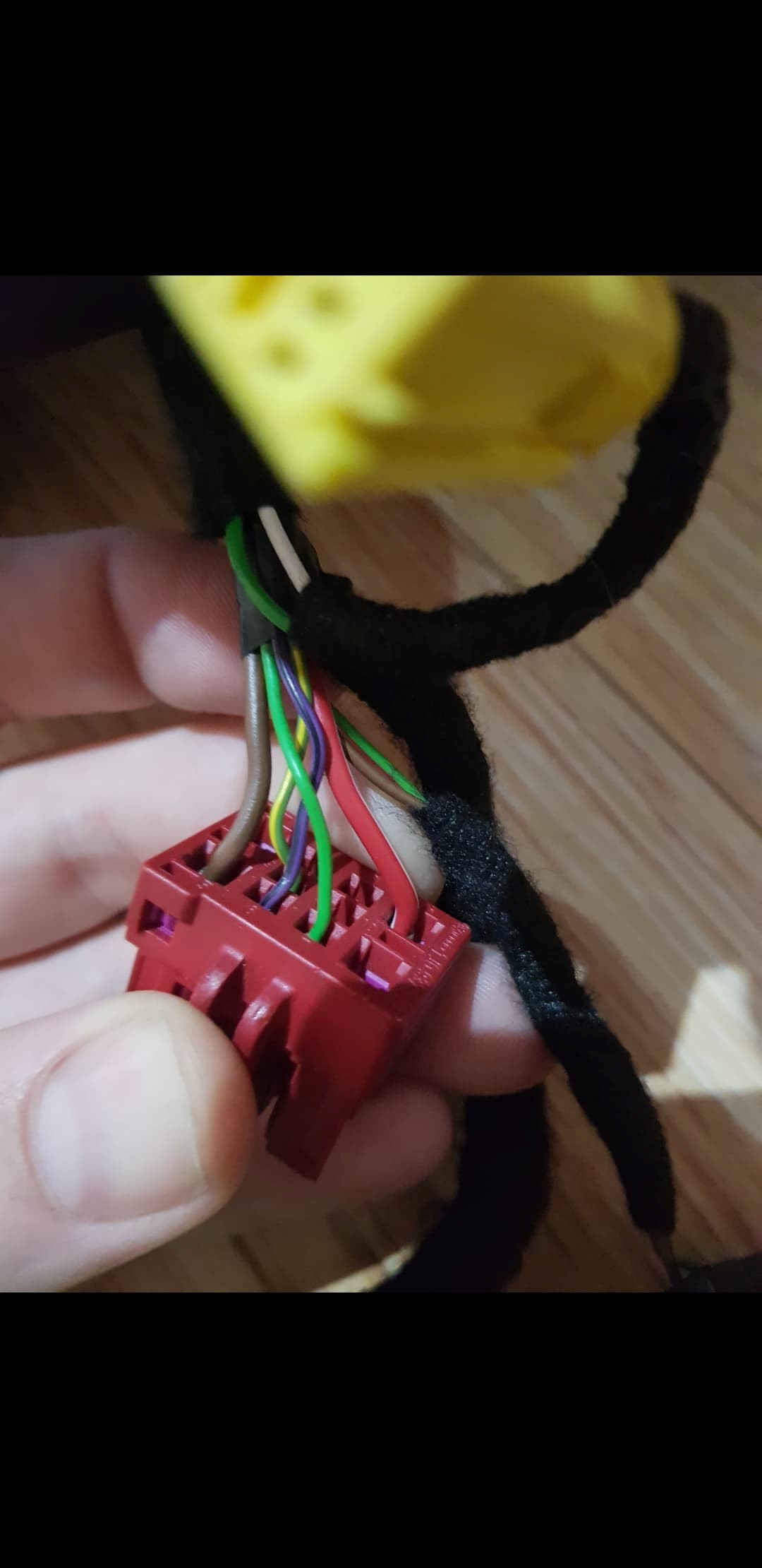

I have just installed the bucket seats into my car, but the bolsters don’t inflate when I press the Sport button. My car comes with comfort seats but I had a pair of Recaro CS Sportsters put on. With these seats a resistor had to be wired into the yellow socket under the seat as it doesn’t have airbags, unlike the comfort seats.
I have now installed the RS bucket seats, but have left the resistors in the yellow sockets and have not plugged the yellow plugs into the sockets as it’s basically the same thing. I have coded for the Sport Seat option and ticked it on the DIS, yet the seat bolsters don’t inflate!
Could someone with bucket seats check what’s the airbag module coding number is? Mine was 0431612 with the comfort seats, does it need changing?

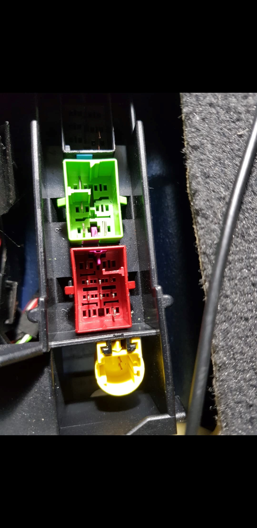

I have a B7 RS4 that also came with comfort seats, and I bought some buckets. All went in fine and the bolsters worked using the buttons on the side, but wanted the sport button to work.
Unfortunately, cars that came with comfort seats from the factory are actually missing 3 wires that allow this function to work - found this out the hard way. Once these 3 wires are put in, and the coding has been done on VCDS, and the option turned on the DIS, then it works
So, you'll see when you put your new seats in - the red connector in the floor of the drivers side is missing 4 pins (3 of these are needed for the sport button to inflate the bolsters). Here is a picture of a car with comfort seats, and one with buckets.
Here is the connector on your new bucket seat (drivers side). Red/white wire is 12V+, Brown is ground, and the other 3 are for the sport button function (and also diagnostics).

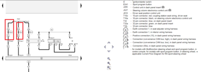

FYI - T10o is the red plug/connection, and the number after it is the pin number of that plug. Once you have a good look at the wiring diagrams you'll understand what is going on.
1. The Purple/black wire (T10o/6) needs to be connected to Pin 17 on the Blue connector going into the back of the dash/dials (T32/17). From memory this is a green/orange wire. Hence you use a splice terminal to connect your new wire to this, ie joining up the purple/black wire to the green/orange wire.
2. The Green wire (T10o/7) needs to be connected to Pin 18 on the same blue connector (T32/18). From memory, this is a green/brown wire.
I connected both of these right next to the blue connector, and taped them up to make it look nice.
By the way, you will have to unplug the blue connector to do this, as it is on the bottom of the connector where it tells you which pin is which.

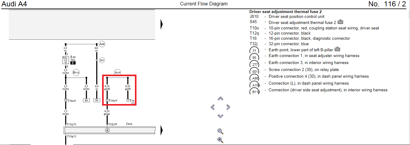

3. The Green/Yellow Wire (T10o/9) needs to be connected to pin 15 on the OBD diagnostic plug (T16/15) - basically just splice into the wire that is already going into pin 15 on the obd plug.
Here are the two wiring diagrams that are relevant for this, I have circled the important bits!
Here is a bad quality picture of the blue connector you will be splicing into two wires coming from it:

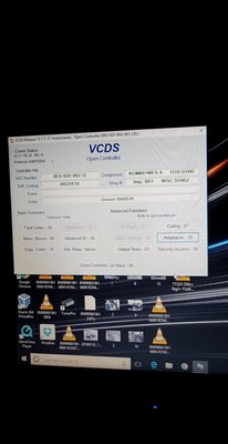

Turn the ignition and get VCDS out.
Go to module 17-instruments, then go to 10-Adaption. Another screen will pop up. In the dropdown menu, go to additional features.
Once in there, you will have a certain number in the box. Add 2 to this number, and enter it in.
Mine was 31300, and I made it 31302 and saved that. This change turns the sport seat option on in the DIS menu.
Once that is done, use your buttons on your steering wheel to go through the options on the DIS. There should now be one at the end saying sport seats - check that option on.
VOILA - you should now have working bolsters on the sport button!
