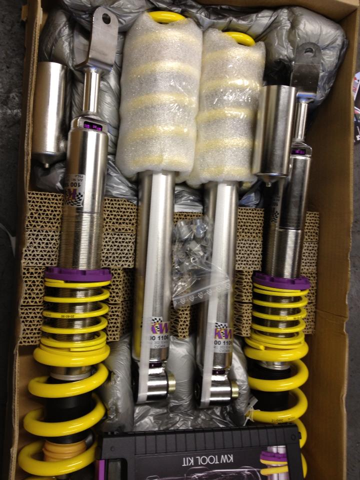

E3ddw
Posts: 102
Joined: Sun Dec 11, 2011 11:58 pm
Re: RS4 Saloon 2006 Emission Control System Fault
Post by E3ddw » Mon Jan 28, 2013 9:53 pm
Well my mechanic just sent me a pic of what arrived at his unit. Will have these fitted tomorrow.
I haven't suffered any DRC poblems yet on my SS suspension.
