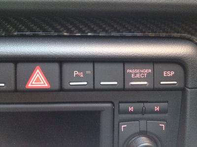

Jules wrote: if you go for the rs and want the sport button to work im sure that will need a feed from the dash button.
I'm fairly sure it isn't the case - the buttons are more like networks than wires. Not like the good ole days.
It's like theres quite a few buttons on the MFSW but only a small numberof wires. IIRC it's voltage controlled and feeds into a steering wheel controler that sends the right CanBus messages to the rest of the car. As such it can be done in software using vagcom and I believe you end up with two sport buttons.
The wheel I have on a different car has about 12 different buttons/functions yet the wheel has 5 wires. 2 for airbag, 1 12+, 1 12- and a signal wire.

adsgreen wrote:I'm fairly sure it isn't the case - the buttons are more like networks than wires. Not like the good ole days.
The buttons on the steering wheel are connected using a single wire LINbus connection to the steering wheel control module (SCSM) that generates the appropriate messages on the CAN bus, which gets fed around the car for the appropriate modules (in this case the two engine ECUs) to listen to.
VCDS (VAG-COM is the old name) can only change the coding to select from the list of available features and not change the software, so if Audi haven't include the software for a particular feature you can't "create" it using VCDS.
