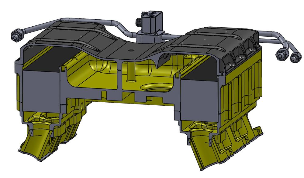

Common misconception that forced induction cars are always under pressure - under cruising conditions the SC will largely be bypassed. So with regards to CB I would expect it to still be present however any italian tune will be more effective as the increased manifold pressure and airflow would hopefully prevent huge buildup as any loose bits would be dislodged before they can solidify and develop.
The only (minor) concern I would have on this is protecting the chargecooler vanes/matrix as from what I've seen on the photos it sits between the charger and intake ports.
Just for the record - This is purely my uniformed speculation !

Not quite sure I follow what you mean here? Do you mean there will be carbon build up on the charge cooler vanes?adsgreen wrote:
If so then I do not see an issue, the carbon build up on the valves of standard cars is made so bad by the heat of the valve and general engine baking the oil and crud to the surface of metals. any oil that makes it around the system from the breathers back into the sc system will not only get converted into a very fine mist by being compressed through the supercharger but it also gets put through the cc cores at very high air speed onto a cooled surface which causes the oil vapour to essentially condense back to liquid form (same way allot of liquid cooled oil separators work on stock cars. You will always get a blackened surface on the fins due to this but it would take a very very very long time for any significant build up to develop.

The issue with the carbon build up is that after alot of trial error the problem is looking more and more connected with the valve stem seals or/and the use and implementation method of internal exhaust gas recirculation. The net effect is that I believe the deposits are coming back out of the cylinder and up the intake path rather than out the exhaust valves. This is why people who have fittted catch can's find nothing as the oil seperator (when working) performs a really good job of pulling the oil out.
The patent from VW going into this makes reference that the deposits are actually pretty susceptible to heat and maybe why a decent italian tune can reduce these and daily commuter cars in start stop traffic suffer more.
What I was thinking is that the mesh on the intercooler is the ideal medium (in terms of size and design, not temperature) for the deposits to form. I wasn't saying this would happen but more thinking out loud.

I think that is too far away to worry about build up on the coolers

I agree with doug on this, its such a long distance away from the valve that i cant see much reaching that far. even from the bottom of our core to the bottom of our manifold is around 70mm, then alowing for the port in the head its well over 100mm away as shown in this cut through.

This is a legit concern, it has been documented on the B8 S4. I am not sure on the distance of the coolers but there was oily residue on the mesh and iirc the car had less than 20k miles on it. I will look for photos...adsgreen wrote:The issue with the carbon build up is that after alot of trial error the problem is looking more and more connected with the valve stem seals or/and the use and implementation method of internal exhaust gas recirculation. The net effect is that I believe the deposits are coming back out of the cylinder and up the intake path rather than out the exhaust valves. This is why people who have fittted catch can's find nothing as the oil seperator (when working) performs a really good job of pulling the oil out.
Re: Mt tts supercharger kit
you will always get oil in a manifold as the cars breathers are fed back in to the intake. The coolers and top of the runners - above the phenolics will never get hot enough to bake that on like on the valves or ports of the heads.
