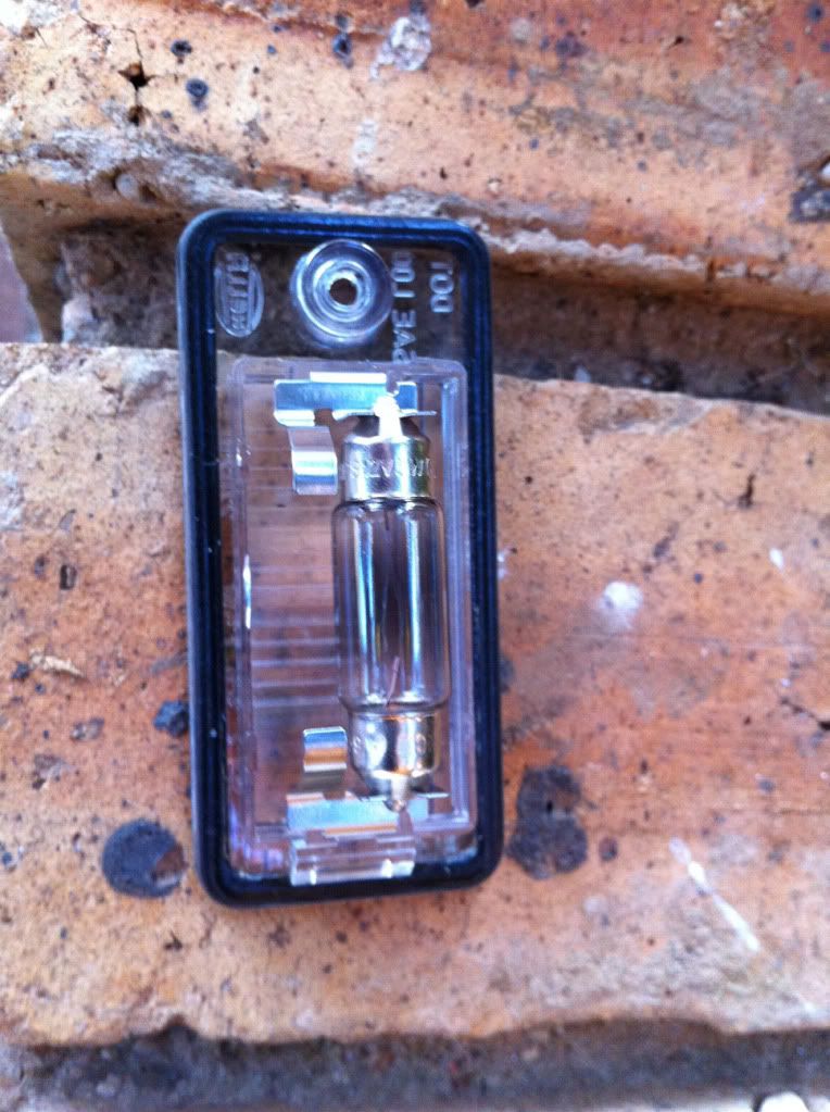

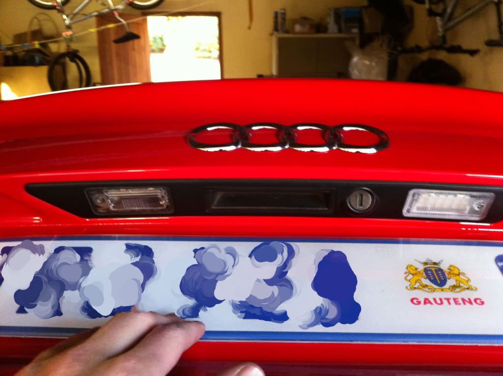

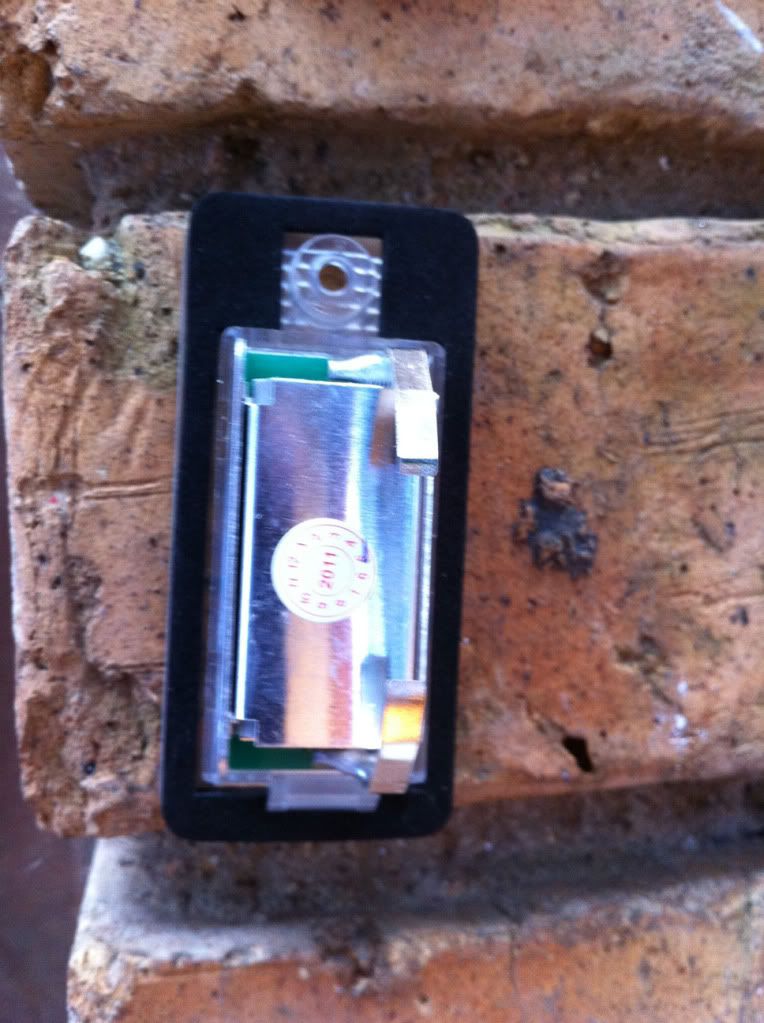

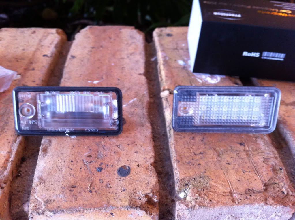

Re: LED number plate bulbs solution
Post by Stoffle32 » Thu Jul 28, 2011 1:41 pm
I got a plug a play solution only cost me around 25 pounds...
The solution just replace the housing...
the housing just clips out so you just put in a new housing here the pics... done in 5min brings up no errors, and no need to install resistors
The LED and Normal Housing..
Normal one
LED One
Right side installed left one the old one
Pic to see the difference
