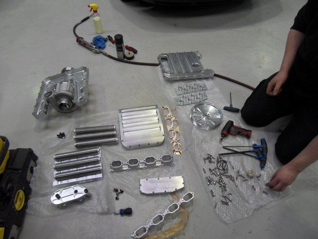

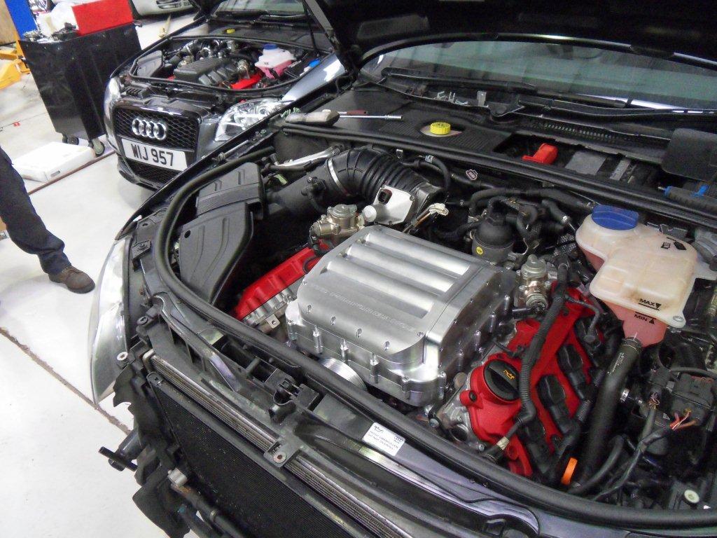

Another option in development for the RS4.

Interesting to be fair I can’t work it out. Is it a single screw? Looks like a turbo. What is the spec?
It does not look attractive as the PES.

It is a rotrex charger - a centrifugal type - looks like half a turbo.
The aim is for 600.
That is the unaddonised/coated development one.
It has really efficent laminova coolers in it.

Kit in first pic might be for a s5 , not for the rs4. The rs4 has an internally balanced crank and therefore a separately balanced crank pulley .

duud40 wrote:Kit in first pic might be for a s5 , not for the rs4. The rs4 has an internally balanced crank and therefore a separately balanced crank pulley .
correct - the rs4 crank pulley is away getting machined now though.
The kit should do around 10psi at high revs and hopefully with efficient intake temps will do nice numbers. The M112 kits will give more torque low down - supposedly - but until they are on the car we won;t know for sure.
