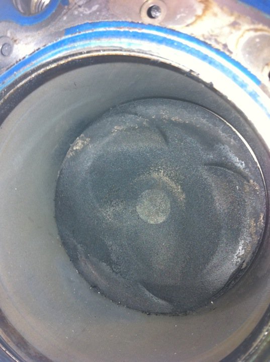

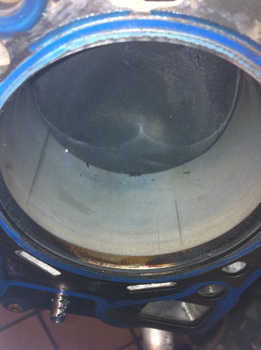

It had cylinder scoring and carbon buildup ,the nikasil had some nasty scores ,I have some pics I will post shortly.

When I was picking my car up the tech was putting the engine back together to send back to Audi technical ,As before they didn't say Arthur I think they will say once the engine gets back to them to have a look for therselfs ,The cylinders are nikasil lined and there was scoring ! I only got a look in one bank as the head was already put on the other side but every bore had some sort of scoring ,As I said I wasn't going to post until my car was back ,I am more than happy with the result of this ,even driving slowly the car feels much more responsive and the 2000 rpm missfire has disappeared so all good

Post by k3ukr » Tue Aug 31, 2010 8:48 pm
Some engine pics

yikes! thats scary.. how many miles does the car have? Is this carbon build up unavoidable then?

Just under 60k ,the carbon build up seems unavoidable the only thing they did say was that coldstart has a part to play ,with the latest software update it helps , still hasn't put me off the car tho!!
