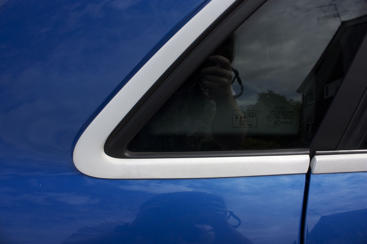

3. the supposed to be brushed aluminum round the doors was all foobar. Audi wouldnt fix this. However this didnt bother me as i wanted the car anyway. ;)

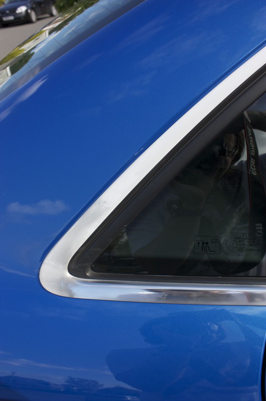

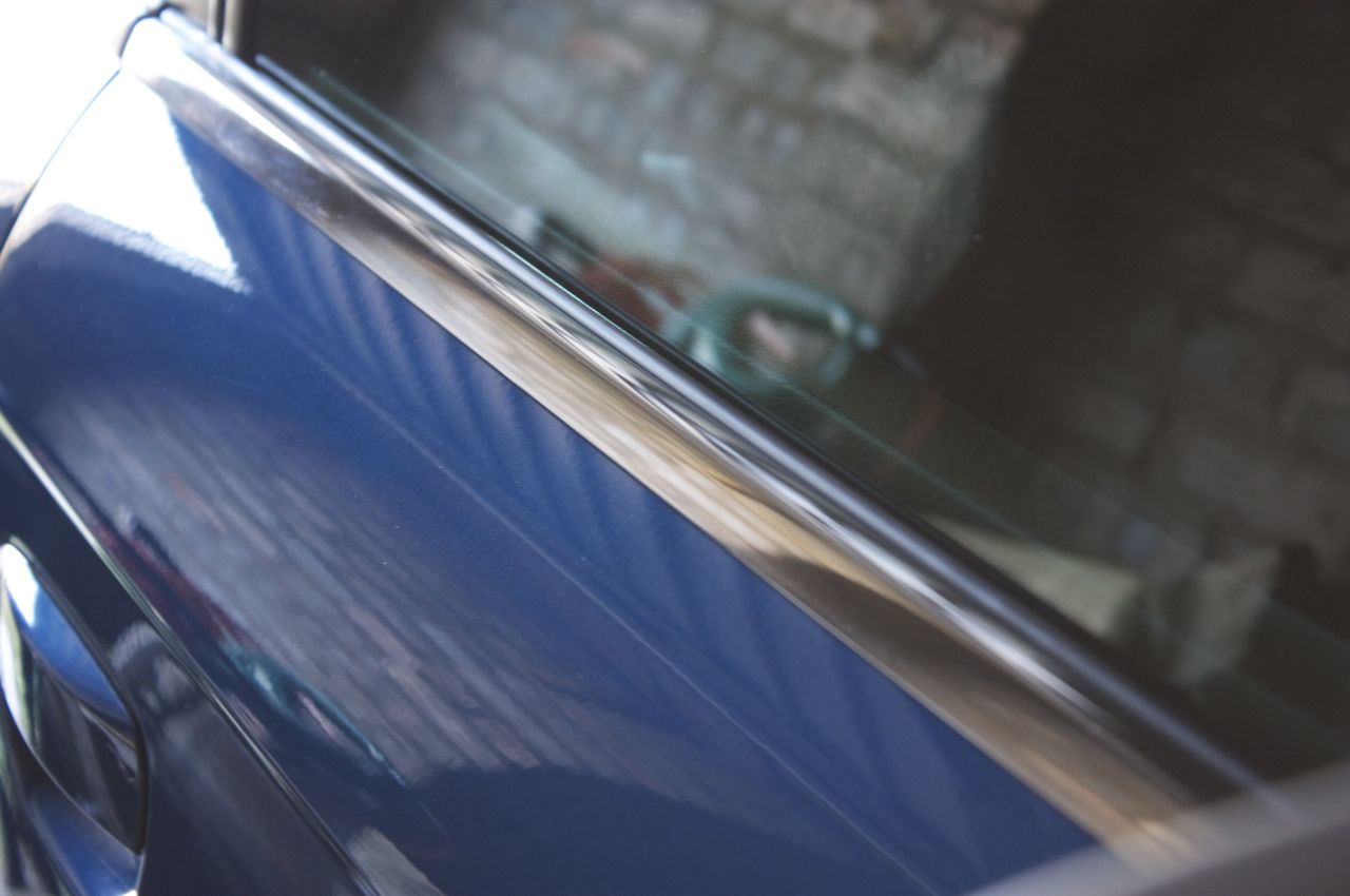

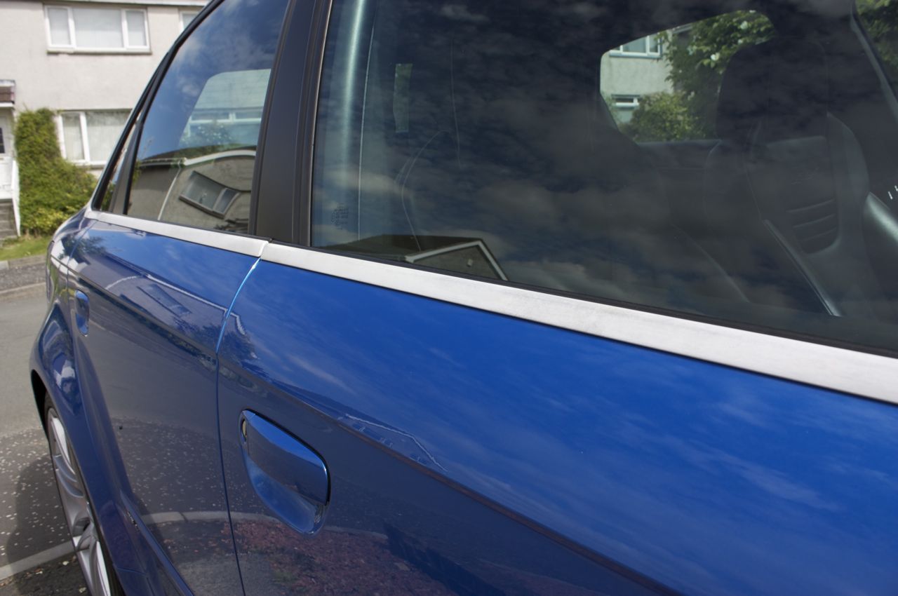

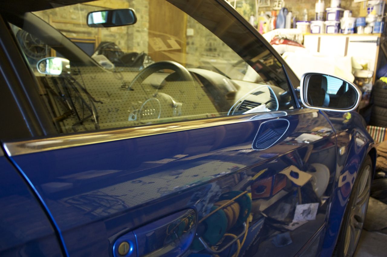

So i started attacking the trim today with the good old megs NXT and decided to strip off the white stuff!! Yeah i know its daft but i REALLY didnt like the look it gave the car. Fortunately the oxidised brushed aluminum finish is coming off and leaving behind a nice finish. I've just been doing it fairly quickly but its hard work! :(
Decided to have a break as my hand is killing me. Was going to use the machine polisher but didnt have any tape!!
heres some before and afters and a partial one. It still needs another going over to remove some of the little bits left behind. No doubt something terrible will happen when the shiney stuff is exposed to the elements but hey ho its better than the white and some wax might protect it ;)

I think he means the 'chrome effect'?
They did look buggered, your right! not sure I prefer the afters though, if I am honest... Perhaps go down the vinyl wrapping route?

Do you mean youve polished off the brushed alloy finish?

yeah polished off the brushed alloy finish. Well if you can call it that, it was all white and wrecked.

Good call on the vinyl wrapping route though. Didn't even think about that as an option. I'll head back out now and finish the job then take a proper pic and put my flamesuit on :mrgreen:

The brushed finish suffers terribly from water marks, and Audi did replace the trim in the 1st 2 years, but not in the 3rd year of the manufacturer's warranty.
The shiny trim now adorn the new generation cars, but I do prefer the brushed effect.

Lets just hope it does not corrode.
Have you thought about having the black optics fitted?
Any more pictures of the polished trim?

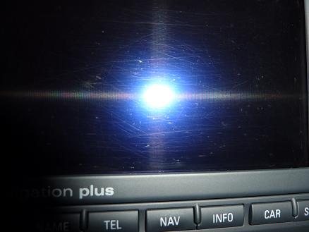

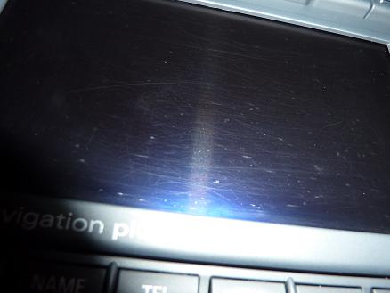

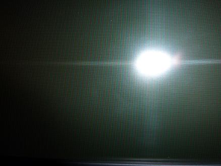

I've used PlastX on my Sat Nav screen. The way it works is by taking the anti-glare coating off. This is where the scratches are. My advice would be to use cotten buds to work into the corners. I was really pleased with the results. I'll get some pictures on later.

I somehow managed to forget the footy started at 19:30, so didn't get much more done! its looking a fair bit better than the white mess that was there. Photos dont really do it justice as the car was in the garage. Got the fiddly bits left like under the mirror and the ends of each door. So its about half done, still got the other side to do.

daytonamc, did you just use cotton wool to apply it to the main bit of the screen or just a cloth?

PlastX Screen Before/after
Post by daytonamc » Mon Jun 21, 2010 9:51 pm
Sat Nav Before/After shots[/img]

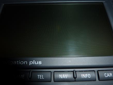

Post by daytonamc » Mon Jun 21, 2010 9:53 pm
After Shot, It takes a couple of applications.

Stubee, I used a Meguiars applicator pad on the screen. not too much pressure and let the mild abrassives do their work in the PlastX. The difficult part is the corners. I used cotton buds and patience. hope the pics help!
