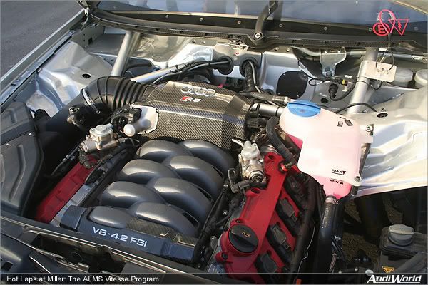

As Art pointed out, the RS4 Challenge car uses a stock air box (and filter!). Once that became fairly well known, anyone working on a replacement air box realized they would have to get out very special smoke and mirrors to make people believe the stock setup was somehow inadequate. And look, it appears to use the stock PCV system as well! The Challenge car achieved 500HP with custom headers, no cats and custom ECU tune - that's it. Awesome engine from the factory...

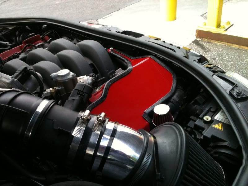

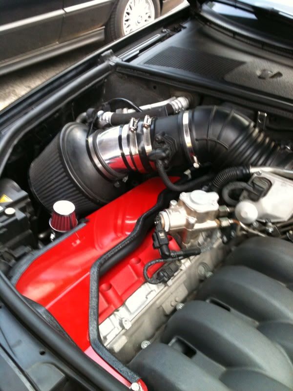

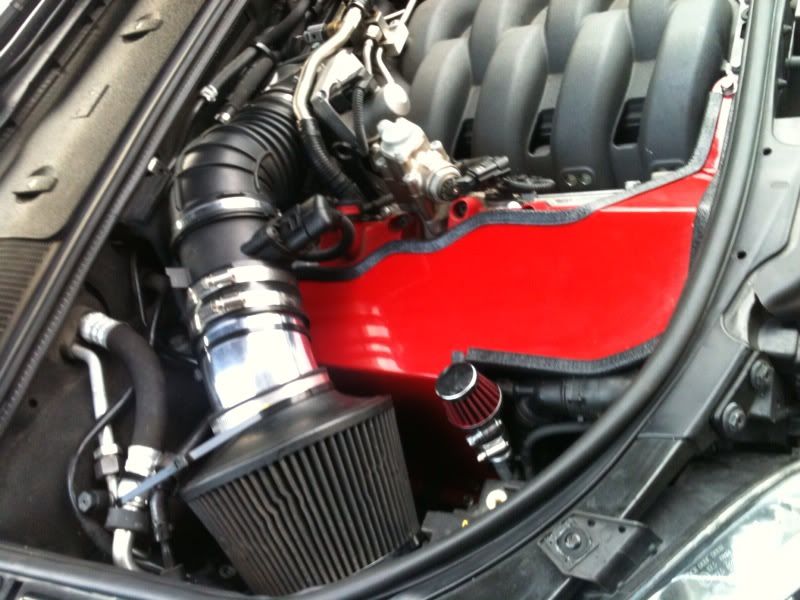

Phillydriver33
Posts: 7
Joined: Sat Aug 22, 2009 6:45 pm
Location: Philly
Post by Phillydriver33 » Fri May 14, 2010 11:12 pm
These are some pictures of the developmental stage. I am going to make an adapter piece out of aluminum however right now i cut up my oem air box and i made modifications to the tubing. Already i have noticed a difference in driving the car is not starving from air at all. I never have to worry about the power flap not opening and i have blocked off a significant amount of heat with the heat shield. Also there are a number of different areas from which air can to get into the engine bay once you remove the air box which takes up a lot of space.
Image[/img]
