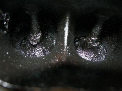

You only need to hook up VAGCOM to your car pre and post cleaning to see that clean valves are worth a few % on your mass flow rate which will translate into more power, although granted, it'll likely be of a magnitude you won't notice it.
How longevity is affected, no-one knows...none of us are knocking up against the design life of the car yet...
Looking at a typical set of RS4 valves below, I'd prefer it if mine were clean, for all kinds of reasons...
Your choices are:
1) Avoid FSI and get a E90/E92 M3 for arguments sake
2) Ignore it
3) Clean it yourself on a regular basis - my option; it'll be the first time @ ~30K
4) Get someone to clean it for you i.e., MRC
5) Devise some kind of workaround like methanol injection a la the 2.0 TFSI boys...
I'm sure there are others...

Up until the end of the summer I reallly only used my car at weekends and then a change of job had me using it daily for 5 miles each way which is when the problems I notced became progressively worse. MRC did mention that my inlet valves where one of the worst they had seen.P_G wrote:You say that though JackS4 yet I have a 58,000 mile RS4 with at this time no such issues, running normal drag times and nigh on 400bhp on a rolling road with a fault at the time. That's why as much as blingbling suggests what I originally said is a 'half empty' statement, there is no concrete proof at this time that it causes significant deterioration in longevity or performance and I would go as far as to say that it doesn't.
I can't see how valves not seating (as it was in my case) wouldn't cause a loss of power. One of photos I have of my engine shows where detonation from the cylinder was escaping into the inlet and actually burning off some of the gunk (although not enough to have the valve seating properly). Happy to share the photo if someone can show me how.
