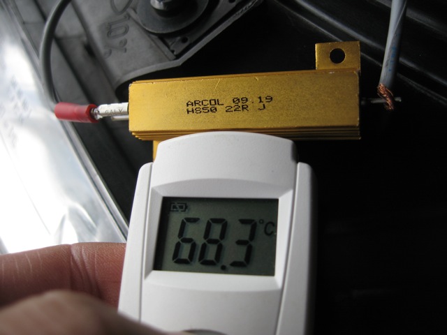

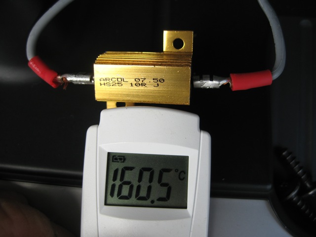

Well, here is my attempt and I tried both resistor 25W 10R (from Andyuk911) and 50W 22R (similar to Rjkflyer, can't get hold of 24R). 25W 10R definite generate too much heat, 160 degrees Celsius whereas 50W 22R put out around 68-70 degrees (which is still too hot to hold with your fingers but should be ok when mounted inside the light cover which definitely give a oem look).
The only thing with 25W 10R, no bulb out error at all but the 50W 22R give the bulb out error with a beep when engine starts but then disappear. Is 24R and 22R that much of a difference? As I think Rjkflyer said he has no error bulb out. So just gotta put up with an extra beep on engine start for now.

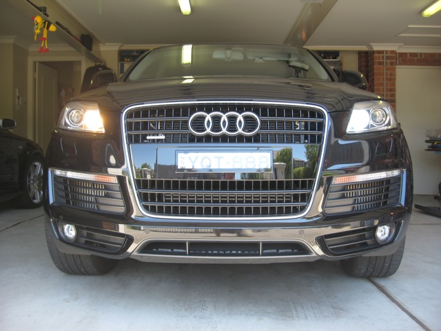

Thanks again Dave. It worked fine with both sides installed (included resistors). Look so much better than oem halogen DRL.
Anyone with Q7 should give this a go. It's a lot easier to do with easy access compare to RS4.
Q7 with LED DRL completed.
Q7 with LED on LHS and oem halogen on RHS.
