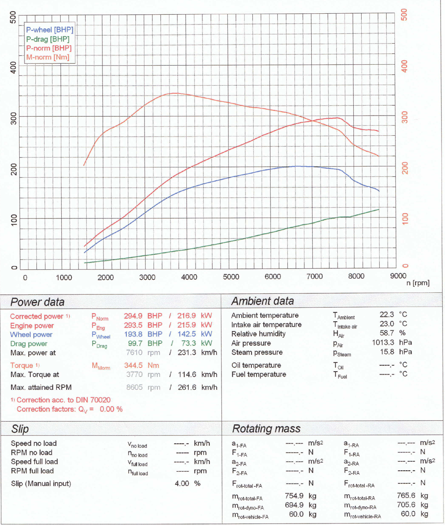

Post by honest » Wed Jul 15, 2009 9:08 am
Results attached, do I have a problem?
Analysis appreciated.

honest wrote:Results attached, do I have a problem?
Yes looks like vacuum fault .. check all lines .. including the exhaust valve ..
Lots to check ...
Lots to check ...
http://www.jlosee.com/images/RS4/PDF/TS ... fold-2.pdf
Second that - there's no "kick" at 5500rpm which suggests that the vacuum is leaking away so the "power flap" isn't operating.
Lots to check ...
my thoughts exactly....that car is making 200 whp...300 Hp at the FW with 100 in losses
what's consistent is all cars have ~100 HP in losses when measured...
a cf of ~35% so 1.35 x whp ~ crank for this car...
so if you make 305 whp x 1.35 ~ 412..
losses ~25% or 100/414
so any car making 300+ at the wheels is making rated HP...
THAT's why wheel numbers are the only ones to consider...
and using a dyno that MEASURES losses

ArthurPE wrote:
if far off, check for vaccum leaks, some folks had them, once fixed the car was as good as new...
you imply you've done dyno runs...post them so I can pick them apart...lol
Several comments. Some engines have had vacuum leaks. Some have had significant intake valve deposits. Both causing peak torque reductions. In a recent (1 week ago) US example, oil returned through the PVC system had mucked up the valves, and the intake manifold ram flap, causing engine check codes. The problem was severe enough to keep the flaps from opening completely.
Personally, I like to use a chassis dyno for comparing uncorrected wheel torque. If done using the same procedures on the same dyno each time the results are very repeatable. Any significant relative differences noted are due to real issues.
