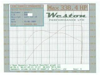

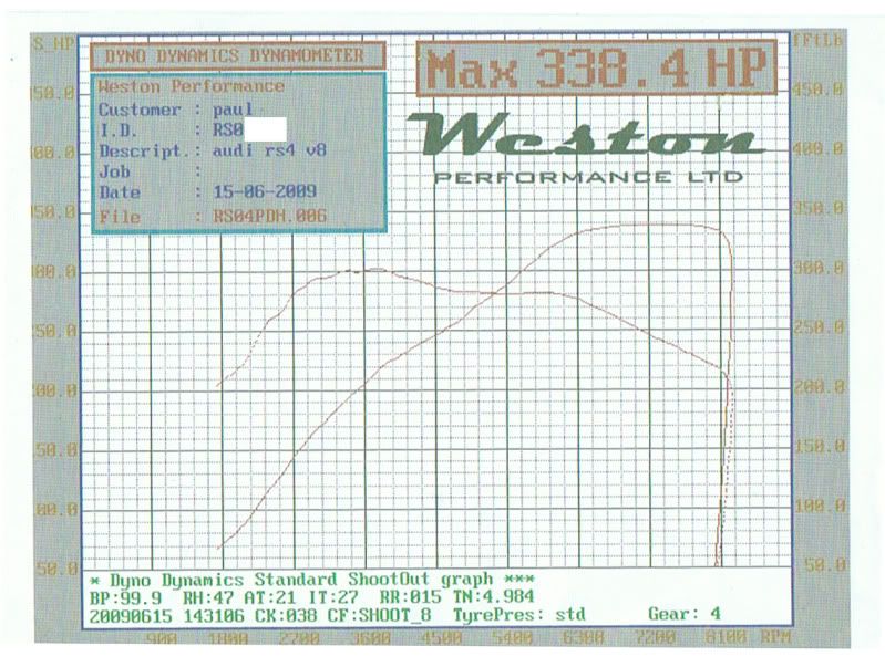

I know there are many variables that can contribute to a low read out ,but i made all the checks possible , i dont have vag-com so i couldnt do a power flap test , I usually run on shell vpower or bp ultimate and Shell Helix Ultra VX 5w/30 ... the lights were off so was the aircon and radio! in fourth gear only ,the car was allowed to cool for an hour ,then warmed up to normal running temp before the run ...im gonna try and post up a copy of the graph shortly ...

That plot doesn't look right, it flat lines after approx 5500-6000rpm, similar to klausters at paramount.

Hmmmmm! An all to common site these days! Looks like the classic problem of the engine being starved of air so you don't get the "powerband" at 5k. When driving the car do you feel like you get a real kick at 5k or does it feel smooth all the way up to red line?
Any chance of posting a larger picture hard to see the numbers along the bottom.

rAudiguy there is a noticable powerband "kick" at around 5000rpm ,..i will try n post a larger image

this seems to have worked
