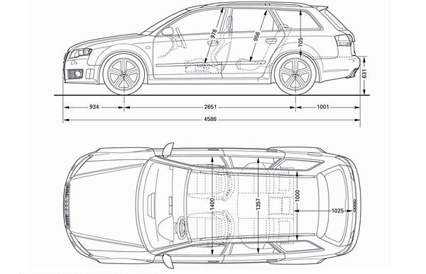

I have attached a picture which should give to a rear passenger view.

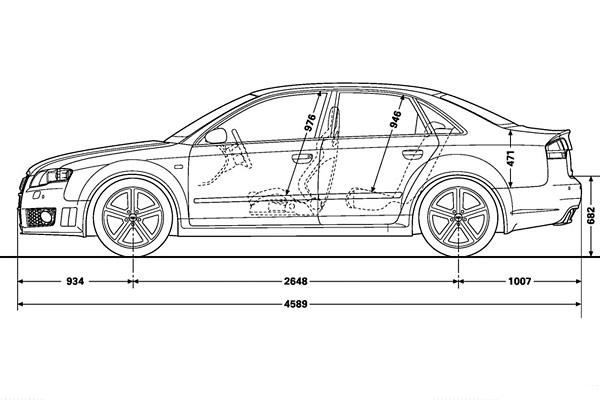

Fishface,
Sorry I did not answer one of your questions; the rear cabin size is identical to the Saloon. The cars are 3mm different in overall length.
There is a little extra head room, but the floor tray sits on the same stage 1 press, the rear press is different.
This is the main reason why there is little or no difference between the ride and handling between them. The ECM has an extra load sensor YEM12 to monitor the rear load, as you would expect you can carry a fair amount of extra weight in an avant so good old Audi have parameters in the ECM to change the front to rear weight distribution.
The Saloon / Avant thing is all about getting used to the car, its more in peoples mind than a lack of ability on the cars part.
