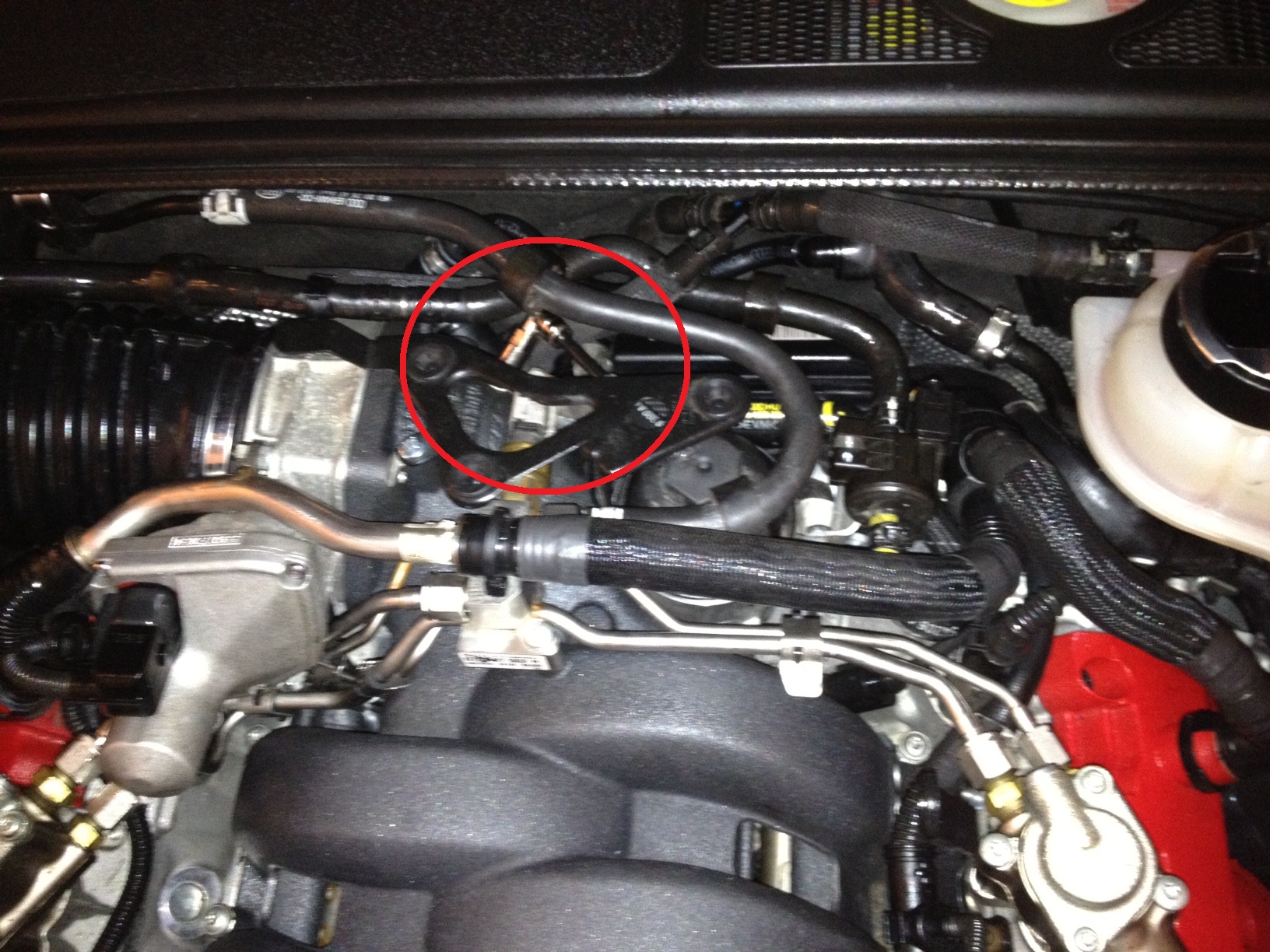

I am running Water / Meth on my RS4 - Works perfect!!

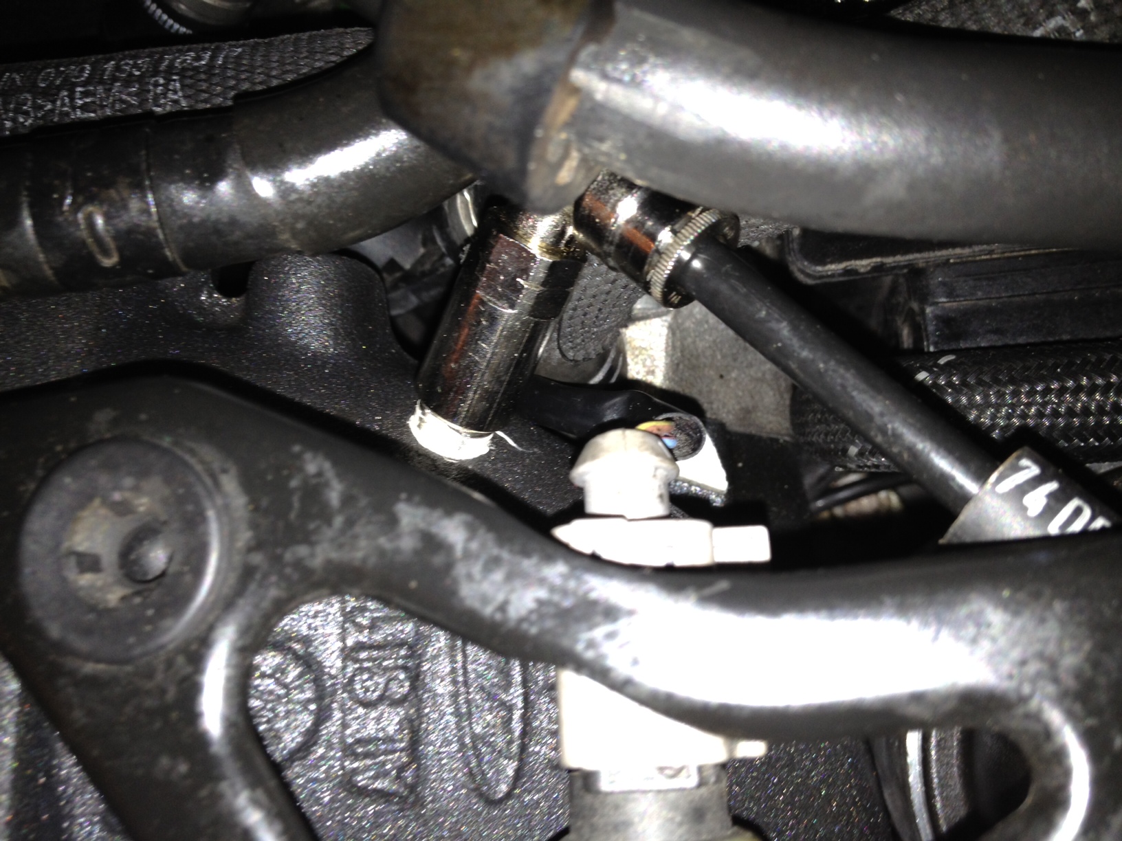

Using "Devils Own" stage 2 (NA) System - hooked up to the voltage on the MAF - Running a DO7 (375ml/min) nozzel after the Throttle Body
Using 50/50 Water / Sunoco Meth (25liter = 14L meth / 11L Wather due to the mass volume)
I only kick it in at 4 / 4.5V (full gas) -
Using the headlight washer "container" (will change this since the engine / Carbon disk heats this to 65C and looses some of the "cooling" idea)
At trackdays I am able to lover my oil temp by 20 - 25C (from 142 > 120C) by switching it on!!
I also have a custom REVO map that runs more advanced timing, since the W/M delays the detonation - You want max explosion on 4degrees piston
This gives you A LOT of tourqe (the expansion of water / meth is much more powerfull than gasolin (my Shell VPOWER RON/MON 99 becomes 116 octane with my aprox 1:20 mixture)
NOTE! - Because this is AFTER the TB, you have vaccum!! - You need a check valve or solenoid valve to close the meth "line" - else it will "sipp" - This CAN be quite dramatic (white smoke and loads of "pops"
You also need to look at the air/fuel ratio (must be around 1:12) - I am running catless and Miltek, so already needed to adjust this before (due to the flow) , but the meth can mess up the mix - You can log this with VCDS lamba values
Let me know it you need more info -

Re: Water Injection to combat carbon build up
Here is my nozzle placement
