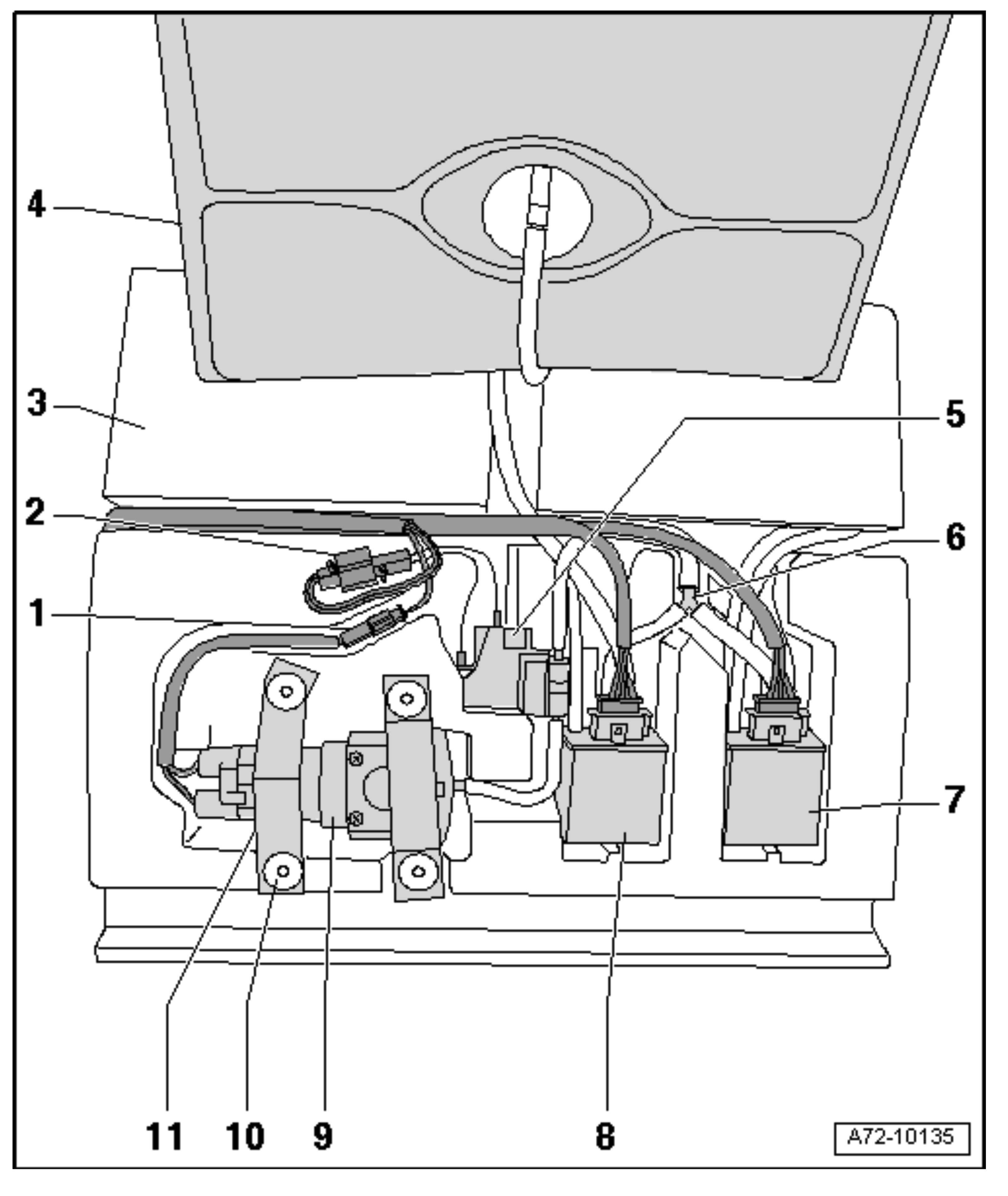

Anyone had experience of fixing the leaking seat valves?
If so... which of the components in the attached diagram, were at fault ?

I had the passenger seat disassembled to see what’s coursing the leak and it looks like its component 8.
After I inflate the air bags, I can hear a slight hissing from component 8 (solenoid valve/switch for the side and thigh support). I’ve ordered one this morning from my local stealer (at over £160!) and it should be here tomorrow. I also noticed that one of the back support air bags deflates slowly too, so I might need to change that one too (component 7).

The culprit is component 8 (for the side ans thigh bolsters). Component 7 is for the lumber support (7 & 8 are the same components and 5 is the pressure valve).
The upper part of the lumber support is also leaking on mine, so it looks like I would need three more valves.

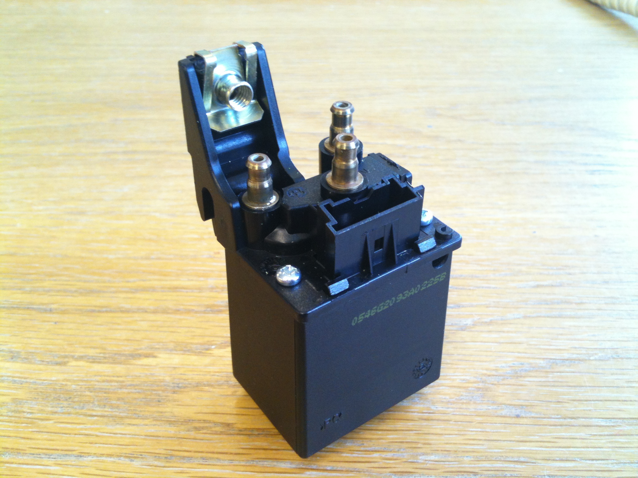

The top photo is the solenoid valve that I've taken apart. As you can see, it's just a couple of simple solenoid valves!

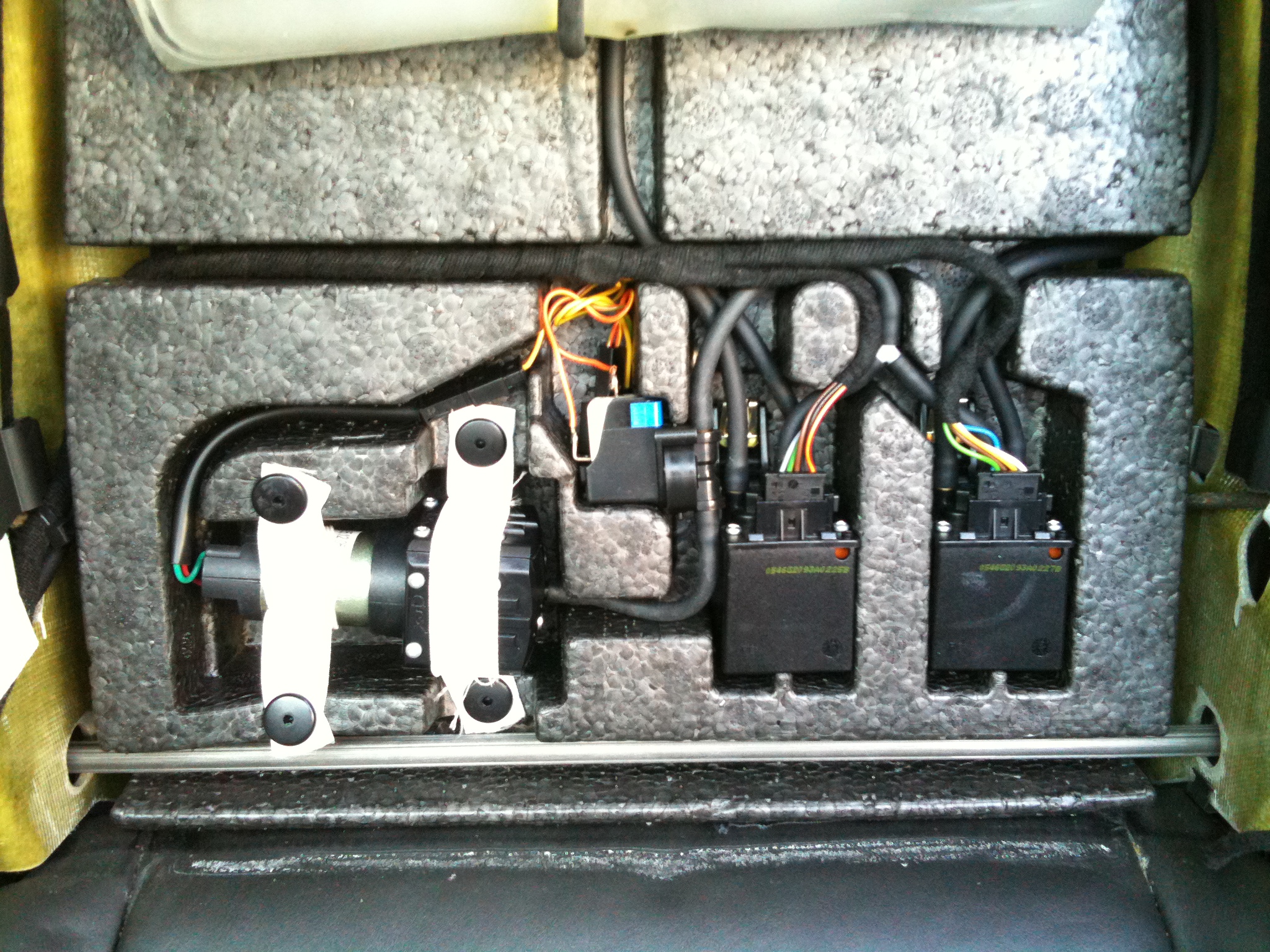

Here is the culprit before I've taken it apart.

Yes, each one has 2 outlets, component 8 controls the side bolsters and thigh supports, component 7 controls the lower and upper lumber supports.
I'm not sure what's causing the leaks, but I think it could be one of 3 things:-
1. If you look closely, there is a ring shape indentation on top of each orange rubber gaskets (a bit like a kitchen tap rubber washer). May be as simple as needing a new rubber bit, which I would doubt you could source.
2. There is a spring under each of the valves (when you lift up the above). May be it needs new springs or just stretch the existing ones.
3. The electromagnetic part of the solenoid is no longer strong enough.
I will have another look tonight if I have time.

Out of those.... I'd probably go for Option 1.
This is such a common problem that I suspect the rubber gaskets as the weak point.

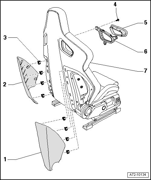

James, I think you could strip the upper leather with the seat in place, but I haven’t tried it as my seats were already out of the car. If you’re going to take the seats out, it’s only held in place by 4 (10mm Spline headed) bolts and three electric plugs on each seat. I’m not sure if you need to disconnect the battery first though (because of the airbag plug)!
All the components in the diagram and photo are located behind the lumber support air bags. So, you only need to take the upper leather off.

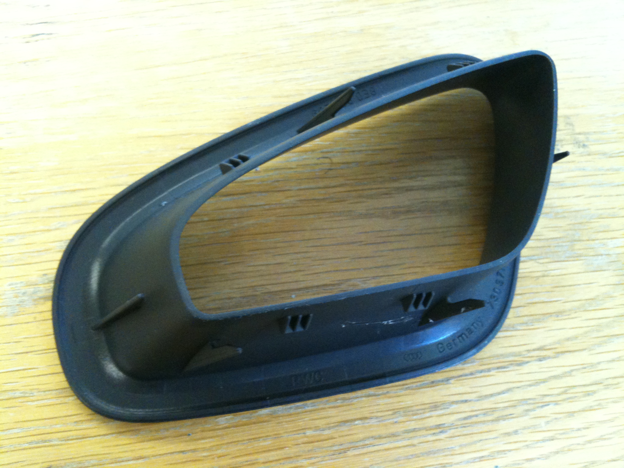

First, take off the 2 plastic seat belt loops behind the shoulders, It’s held on by 4 tab and some glue (see photo), you need to get your fingers in the top and bottom part to dislodge the tab and glue. There are some clips that hold the bottom part of the leather in place, I would try to leave them and start on the side by pulling the leather away from the back shell. Once you got the leather off the back shell, you need to be careful and peel the leather off the foam. It’s held on by Velcro and some clips, try not to pull the clips and Velcro strips off the foam, otherwise you need to glue them back on. Now the leather should only be attached at the bottom, move the foam and you can see the lumber support air bags, the valves are behind it.
Good luck.

These diagrams may help others too...
(the item marked 80-200 is the Audi specific tool for the job)
