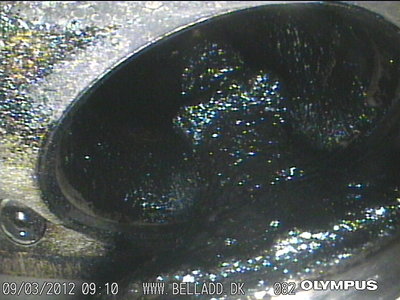

Tony, show them this post and it is apparent that it will be useful:
don wrote:
adsgreen wrote:This is a great example of what I mean.
http://forum.rs246.com/viewtopic.php?f= ... th#p546640
Hell of a lot cheaper than manifold off and would give a good benchmark.
Wow that is an amazing effect! :shock: The first I have heard of it but a simple solution of injecting a water/methanol mix in the intake. I thought that was just something that people used for hooning or at the drag races. Alcohol and water are really good solvents so no reason why it wouldn't work and looks like it does. Though some (Audi) may not like the idea of injecting methanol and water into the engine so warranties may be concern though as I understand it if done properly there is no harm to the engine. It's also not quite clear what ratio of water to methanol he used but for cleaning purposes it presumably does not have to be as high as the 50:50 mix at the races.
before:
after:
VCDS HEX+CAN owner - covers all VAG cars (PM me if you require VCDS coding in Kent)
