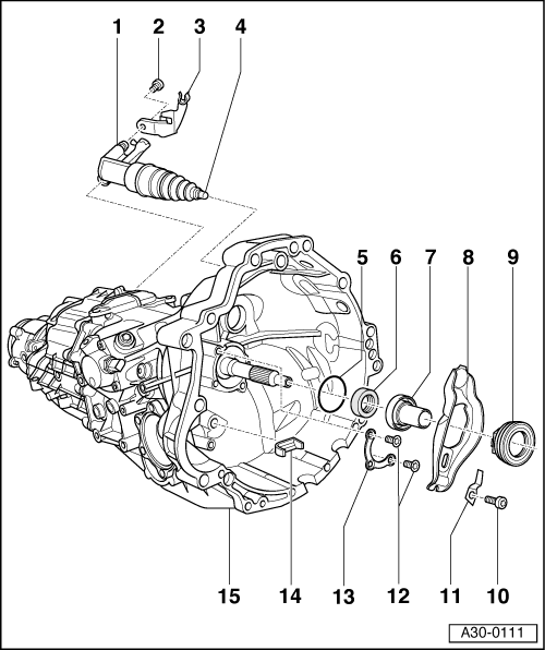

interesting http://www.schaeffler.com/remotemedien/ ... pkw_en.pdf
• Release-bearing guide tubes
Check the guide tube for correct fitment. Guide tubes should be centered and parallel to the transmission input shafts. Damaged or worn areas on guide tubes may prevent the release bearing from sliding freely This can lead to judder, clutch slip, heavy or difficult clutch operation. Damaged or worn guide tubes should always be replaced as part of a professional clutch replacement. LuK-AS has a range liste within our passenger car catalogue, identified against specific vehicle applications.
Note: Audi and VW models still found to be fitted with a plastic sleeve should have them replaced with the metal version LuK-AS No. 414 0002 10.
as I noted before, ours have plastic (or used to?)
plastic
metal
plastic
metal

like many i have also suffered the sticky clutch syndrome, i too thought originally that it was the sleeve that arthur has pictured.
when i replaced my clutch i bought a new guide sleeve convinced that when it was stripped down the sleeve would show some wear,
however once stripped the sleeve was mint no signs of catching or binding so i didnt even fit the new one just loba pressure plate loba clutch plate and release bearing.
15000 miles later everything still ok, so maybe it is oem pressure plate.
the original sleeve in my car was metal as was the replacement pics below.

Re: sticky clutch weirdness
is that bolted to the housing like the flanged one?sar wrote:like many i have also suffered the sticky clutch syndrome, i too thought originally that it was the sleeve that arthur has pictured.
is there a clip that holds it down?
i never seen with my own eyes how it was attached arthur but i presume these picks from elsawin are accurate.ArthurPE wrote:is that bolted to the housing like the flanged one?
b7rs4 phantom black, titan pack.
sar wrote:i never seen with my own eyes how it was attached arthur but i presume these picks from elsawin are accurate.ArthurPE wrote:is that bolted to the housing like the flanged one?
thanks, makes it perfectly clear
what is the texture/coating on the one you didn't use? was it the same as the one installed?
I'm pretty sure I've isolated what is hanging it up
mine seems to do it at the bottom knuckle or transiton point for the OCS, you can feel it hesitate, and I'm guessing when hot (fluid, friction springs, etc.) it just doesn't have enough force to return...at the bottom of the pedal it transitions from aborbing energy to releasing it in the middle of the stroke (to reduce leg effort required)
I'm going to make some shims to add some tension/preload to the spring, see if that helps
