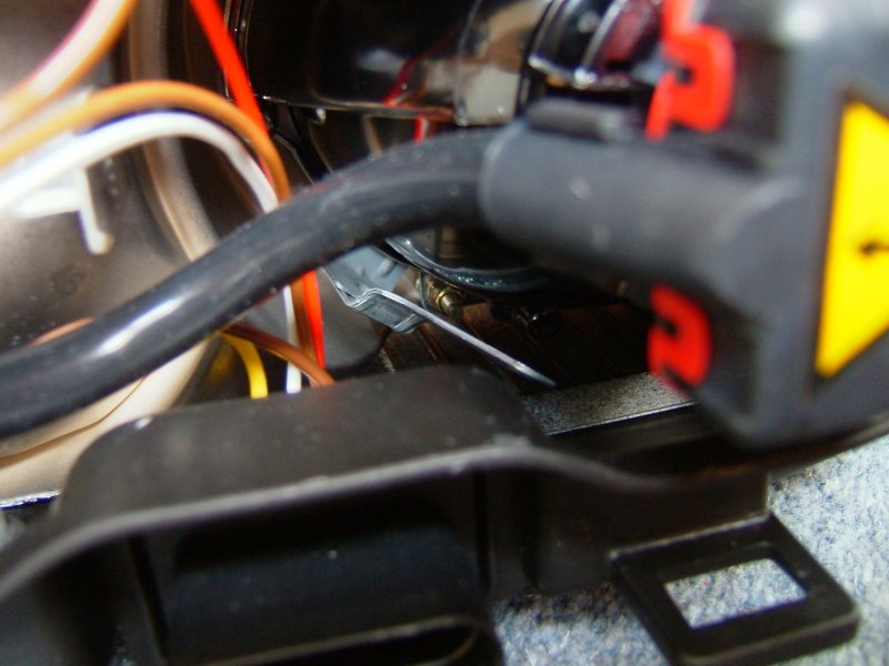

Inside the headlight unit there is a small lever just below the projector unit. If you flick that upwards a shutter moves over part of the beam to make it flat.
It is a little fiddly though. It's probably easier to take the headlight out to do it.
Here's a picture of the lever on a facelift S3 headlight.
HTH
Headlight shutter lever.jpg (67.31 KiB) Viewed 1094 times
