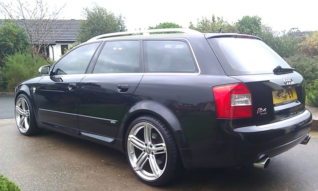

Re: Rs4 alloys will they?
Hey guys. First post here and hopefully I can be of some help. A lot of misinformation in this thread...
I have had B7 RS4 wheels on both my B6 S4 and now my B7 S4. As you know they are 19x9 et 29. They have fit quite well as long as you run a slightly narrow tire. 235/35/19 to be exact. I know many people have ran this setup with little to no rubbing. I rub in the rear when I hit massive bumps but that's about it. If you're planning on going any lower than I am you may want to consider 225/35/91's, at least in the front, as that's where you'll run into problems.
Here's a few pics of them on my B6 and my b7 (current):
