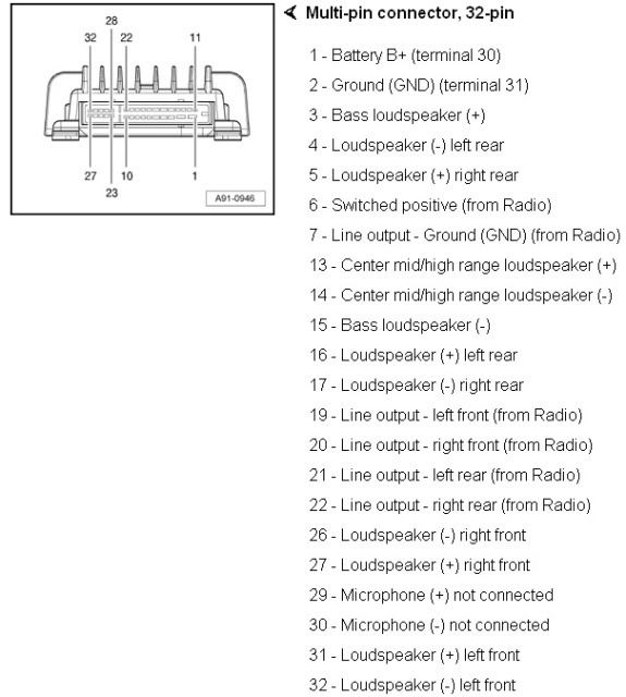

May be of some use to you for fault finding. Use another speaker to test output from the amp
AMP DIAGRAM

Post by Audidoody » Fri Aug 20, 2010 8:13 pm
Right thank you. I've sorted it. Somebody had cut the cables to the rear speakers to T in an amp I suspect ?. Because they had cut the cables so tight to the plug they decided to leave re-connecting them to some other mug (that'll be me then). They're not drowning out the V8 though :)
