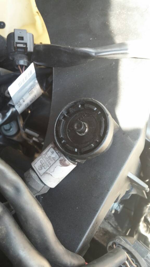

Sedan,does anyone know where this particular item is from? Thanks for the help. it

Is it just a grounding point? Whereabouts is it?

That looks to me like the engine mount sensor, looks like someone has broken it off?
Here is a pic of mine when I changed it, you will see the connector on the side of the engine mount. I changed both of mine the parts were £380 with discount.... then you got the bolts etc needed on top of that when you change them. You will probably have a fault code related to the engine mount on that side too if its not connected?
