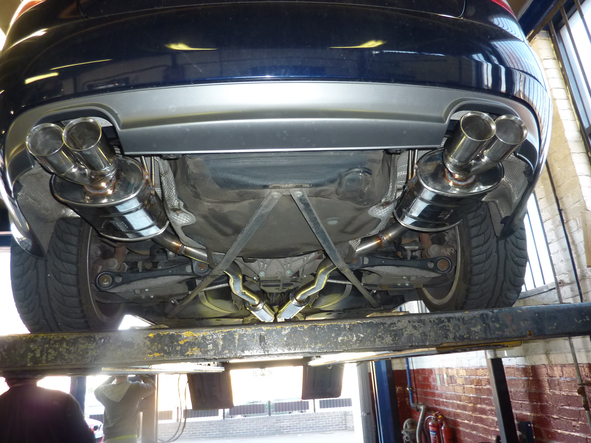

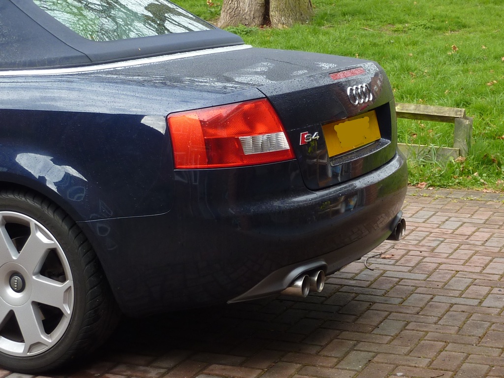

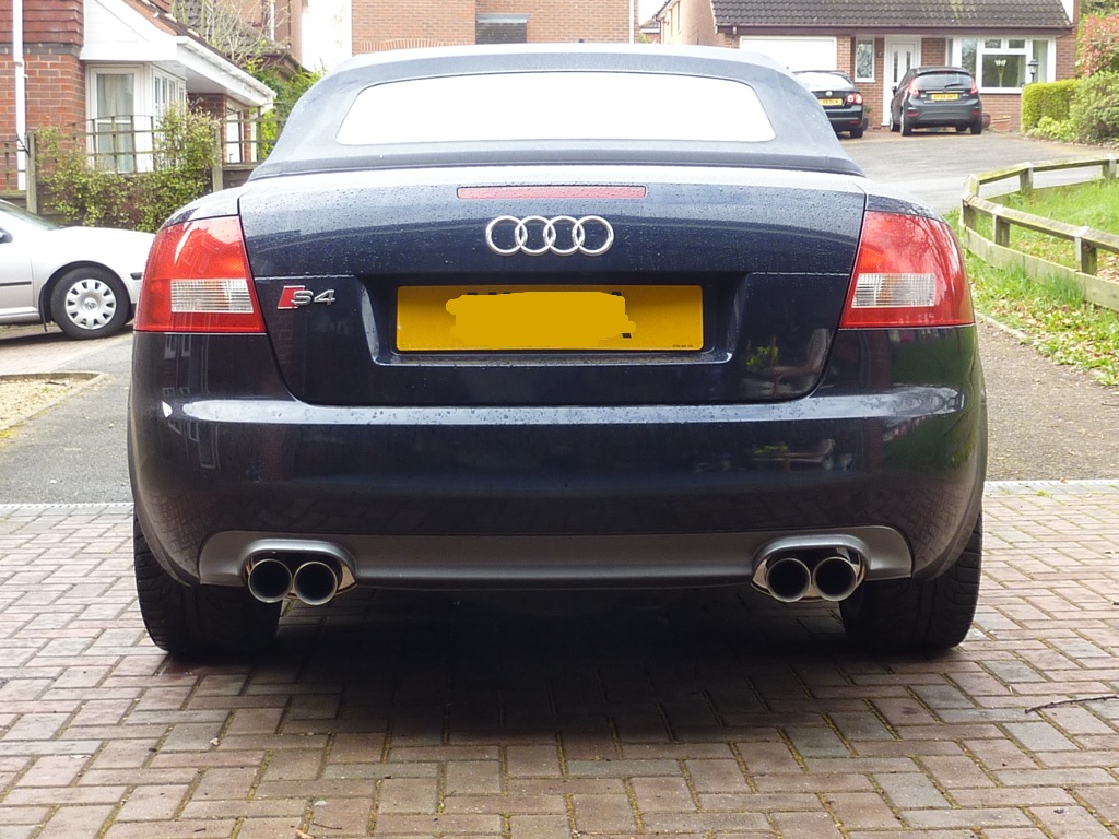

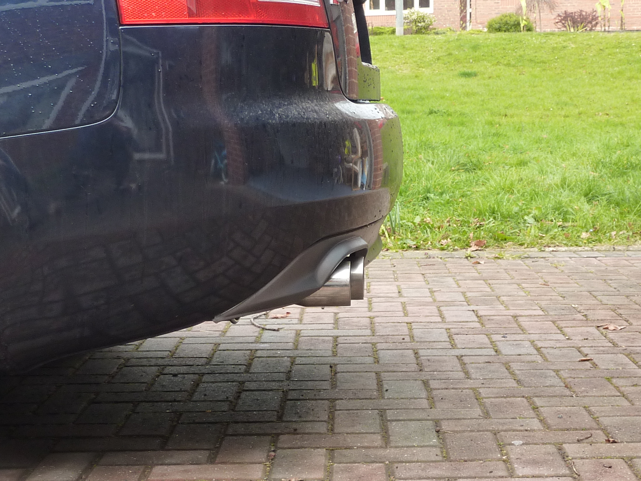

Hi All
Just thought I'd upload some pics of my new custom built exhaust from MIJ.
I have a B6 cab but liked the quad pipe appearance of the B7 so swapped the valance for a B7 one to accommodate the pipe.

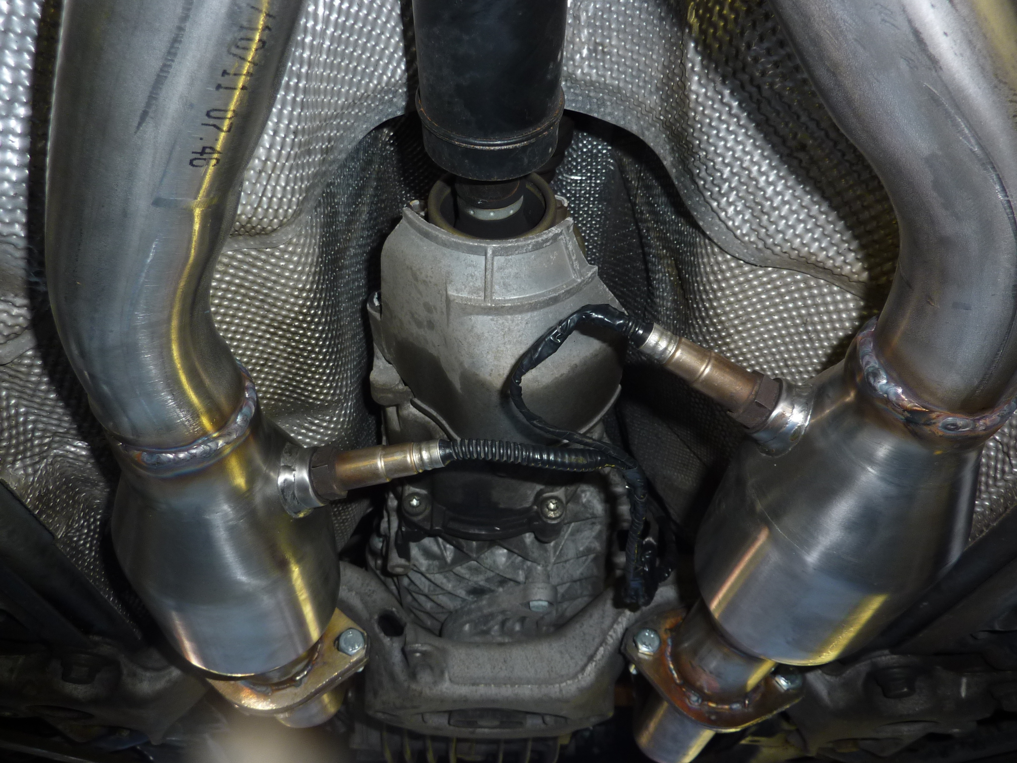

Whole system was replaced...new down pipes without precats and sports cats where the old main cats were. The cables had to be lengthened to get the lambda sensors to the back of the cats :boohoo:
It now does sound awesome....like a proper V8 :jump_clap: but not so loud that the neighbours get upset!! There is a bit of a drone around 1250 - 1750 rpm but after a couple of days I hardly notice it so it can't be too bad!!

Nice.
Welcome to the club (that's the club that have undone Audi's exhaust-taming).
