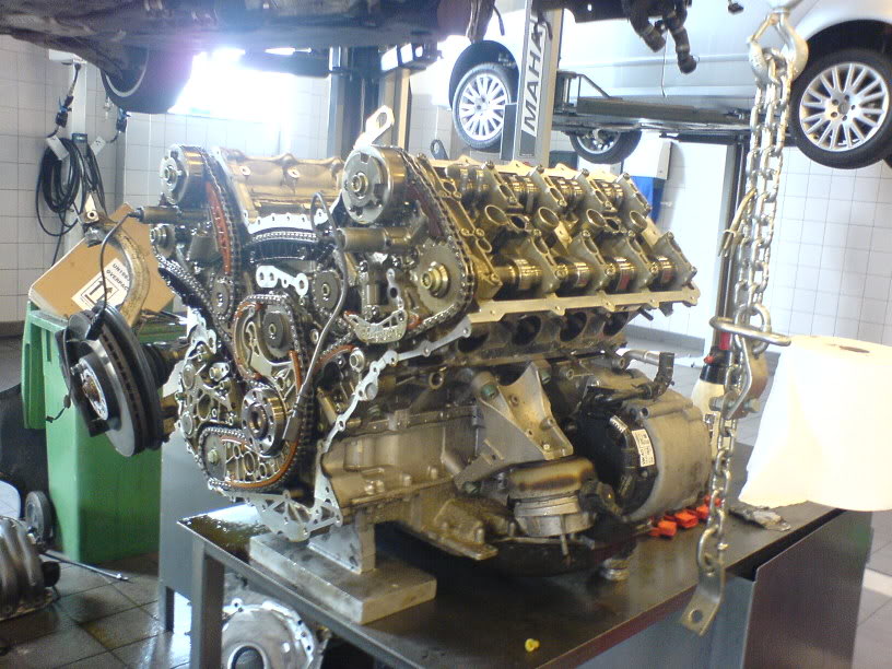

Incredibly complex, you have to see if to believe it! Had this image saved on my 'puter before I even bought mine, makes you wince at Audis book 20k oil intervals. One reason I paid a fraction more for a car that had been serviced more regularly than the others I looked at (had 5 AVS stamps - others of the same age and mileage only had 2 as per Audis guidelines)gottanS wrote:If you google 'audi s4 v8 engine' for images you will find one showing the back of the engine and that a lot is going on. I would want much more detail before going down this route. I would talk to Unit 20 or MRC about this.

Right an update. Get the tissue ready.
Bit the bullet and instructed Audi to proceed. Engine out and stripped back and they have found that two of the the chain tensioners were knackered and were just about to fail. Been to see them myself and part of one is broken and it was only the mounting bolt that was keeping the chain in place which meant no rattle. One of the chains is worn also where it was hitting the bolt.
Anyway, getting all the chains, tensioners, actuators and all other ancillary bits and pieces replaced and also the clutch has never been replaced so getting an uprated unit stuck in and new flywheel.

Will post some pics of engine out and damage soon just for your info and future reference.

Re: The engine is coming out!!!
HI,
Can you get pictures up here of the parts that have been damaged?
If the chains weren't making a noise, then there should have been no problem. There is no way that the "screws" would be keeping things calm - you would have heard them from 10 metres no probs'.
Get some pics for your own benefit. Take pics of the tensioners, chains - the chains will be REALLY worn if rubbing against the "screws".
Again, if there really are no tensioners, then you would hear the chains ALL of the time.
It's very odd.
Regards, Chris.
Just as an extra:
The damaged chain should be "damaged" across it's full length, so check that as well.
I spent a long time looking at that photo, very scary but driving it makes you forget, stil £5.2k is going some.
